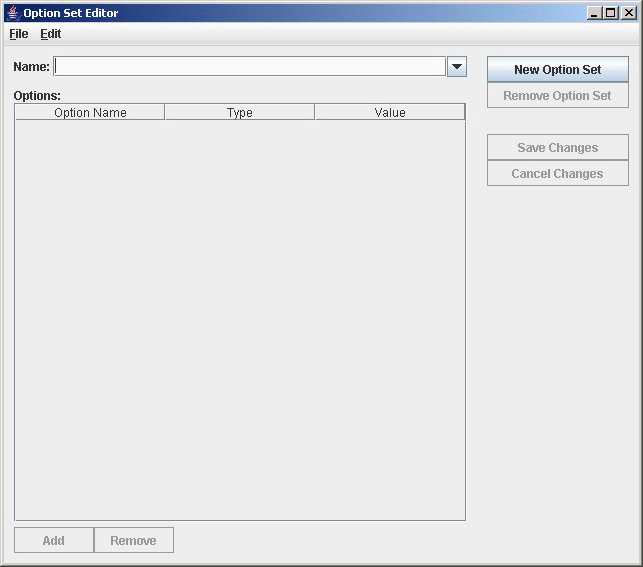

option_set_editor Java GUI application for editing the agent_option_sets.xml file

2.4 The Option Set Editor
To facilitate easy creation of option sets for transformations, an Option Set Editor application is included with Transformation Server. This application is launched using a batch file called option_set_editor, located in the installation's root directory.
2.4.1 Using the Option Set Editor
Once launched, the editor displays its main screen, shown here:
Figure 2-1 Option Set Editor Main Screen
Option Set Editor main screen
Here are the steps to follow to create an option set using this application.
  1. Click New Option Set to create a new set.
  2. Type a name for the new set in the Name field.
  3. Add an option by either clicking the Add button at the bottom of the main screen, or clicking Edit then Add Option.
  4. By default, the new option will be xsd:boolean, but this value can be changed by double-clicking on xsd:boolean in the Type column, and then selecting a new option from the drop-down list that appears. Similarly, you can change the value for any option in the set by double-clicking on the current value in the Value column, and then either selecting a value from the drop-down menu (if applicable) or typing a value into the field.
  5. If you wish to remove an option that you've added, click it to highlight it, and then click the Remove button, or click Edit then Remove Option. You can also remove all options from the current set by clicking Edit then Remove All Options.
  6. To begin a new option set, you can click New Option Set or Edit then New Option Set.
  7. When you are ready to save a set to an XML file, click Edit then Save or Edit then Save As.
  8. You can open an existing option set for editing by clicking File then Open. If at any point you wish to revert to the file's initial state prior to editing, click the Cancel Changes button. Clicking this button when working with a set that has not yet been saved simply brings you back to the blank default start screen.
    The Option Set Editor can make intelligent decisions about when to base64-encode text. For example, if a user creates a stringData entry in the Option Set Editor and the character set of the string is not UTF-8-encoded, the editor will automatically base64-encode the string and set the base64 flag to true. Such behavior explains the possible presence of <base64> tags in the output.
