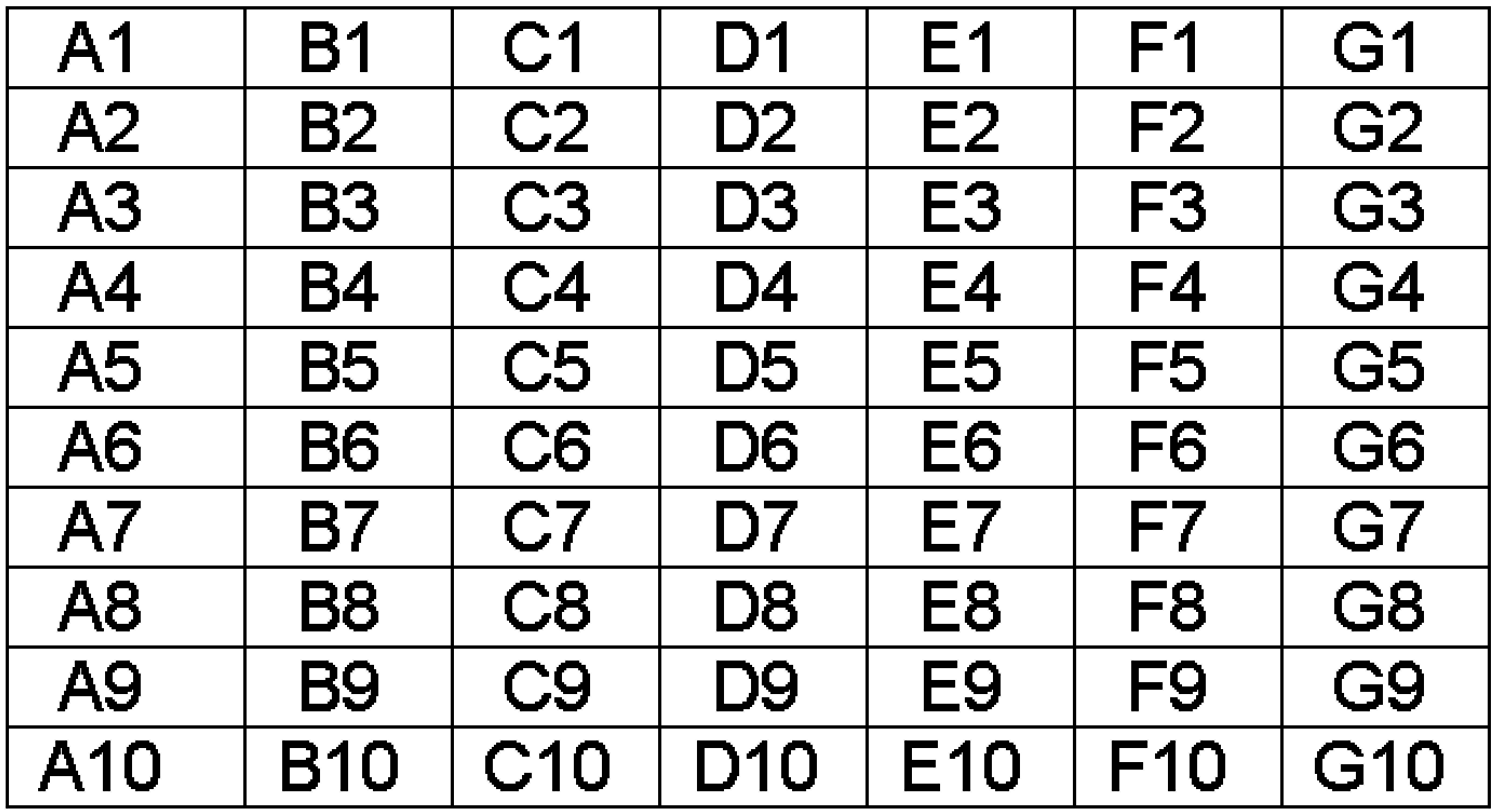

sections.x.grids
Type: Repeatable
Description: Only valid for spreadsheet and database formats. This permits access to the "grids" inside a section or sheet of a spreadsheet or database file.
sections.x.grids.x.body
Type: Repeatable

SCCOPT_EX_GRIDROWS (gridRows): Integer greater than or equal to zero.
SCCOPT_EX_GRIDCOLS (gridCols): Integer greater than or equal to zero.
SCCOPT_EX_GRIDADVANCE (gridAdvance): DOWN (advanceDown), ACROSS (advanceAcross)
SCCOPT_EX_GRIDWRAP (gridWrap): TRUE (true), FALSE (false)

To further explain the grid system, consider a multi-sheet spreadsheet workbook as an example. Each sheet in the spreadsheet workbook is broken into a collection of grids. Each grid has a fixed maximum size and is a rectangular portion of the spreadsheet. The size of the grid is specified as a number of spreadsheet cells. For example, consider the following 7x10 spreadsheet:
If the OEM wanted to break it up into 3x4 grids, 9 grids would be produced as shown in the following diagrams:
Normally, all grids have the same number of cells. The exception is that grids at the right or bottom edge of the spreadsheet may be smaller than the normal size. Grids will never be larger than the requested size. For this reason, grids can easily be navigated by using "up", "down", "left" or "right". One thing that grids cannot do is address individual cells in a spreadsheet (except, of course, in the degenerate case of a grid whose size is 1 x 1).
HTML Export does not force deck/page breaks between each grid. Therefore, if the template writer wants to limit each deck/page to only one grid, they should force the break in the template.
Not all output flavors supported by HTML Export support the creation of tables. If the output flavor does not support tables, HTML Export will still support grids. However, HTML Export's normal non-table output will be what is presented in grid form. For example, if "[A1]" represents the contents of cell A1, then we would export the following for a grid of size (2x2):
If grids.1.body is:
[A1]
[A2]
[B1]
[B2]
then grids.right.body is:
[C1]
[C2]
[D1]
[D2]
and grids.down.body is:
[A3]
[A4]
[B3]
[B4]
