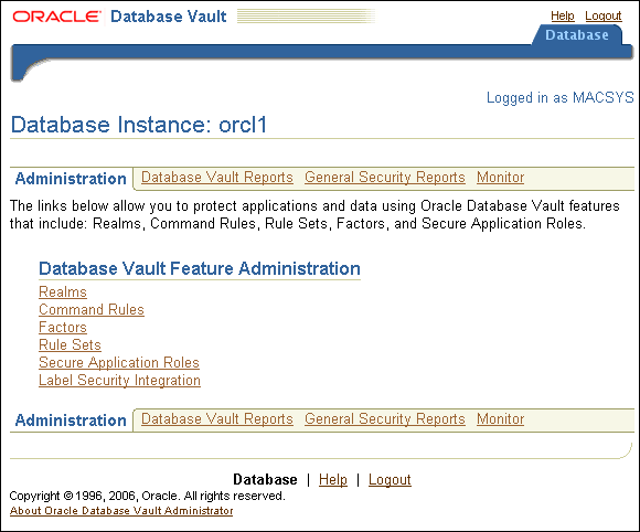

Figure 3-1 shows the Oracle Database Vault Administrator home page, which appears after you log in.
Figure 3-1 Oracle Database Vault Administrator Home Page
Database Vault Home page
Description of "Figure 3-1 Oracle Database Vault Administrator Home Page"
