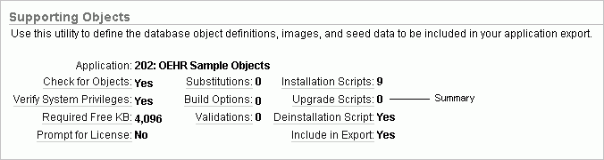

The top of the Supporting Objects page displays the application name and indicates current selections for the following: Check for Objects, Verify System Privileges, Required Free KB, Prompt for License, Substitutions, Build Options, Validations, Installation Scripts, Upgrade Scripts, Deinstallation Script, and Include in Export.
Description of sup_object_sum.gif follows

  1. On the Workspace home page, click the Application Builder icon.
  2. Select an application.
  3. Click Supporting Objects.
    The Supporting Objects page appears.
  4. Under Upgrade, click Upgrade Scripts.
  5. To create a script, click Create.
