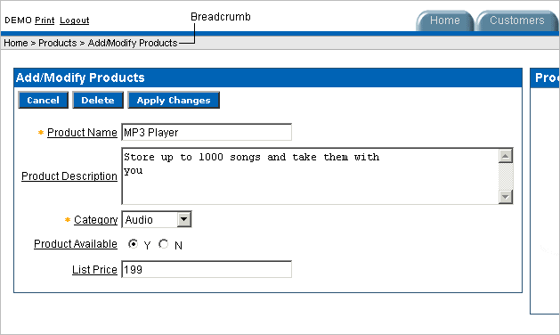

Breadcrumbs provide users with hierarchical navigation. A breadcrumb is a hierarchical list of links that display using templates. You can display a breadcrumb as a list of links or as a breadcrumb path.
Topics in this section include:
About Breadcrumbs
A breadcrumb trail indicates where the user is within the application from a hierarchical perspective. In addition, users can click a specific breadcrumb link to instantly view the page. You use breadcrumbs as a second level of navigation at the top of each page, complementing other user interface elements such as tabs and lists.

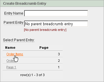

  2. From the Breadcrumb list, select Breadcrumb.
    The Create Breadcrumb Entry form appears.
    Description of breadcrum_creage_pg.gif follows
  3. In Entry Name, enter a name for the breadcrumb.
  4. For Parent Entry:
    • To specify a parent, select a parent page from the Select Parent Entry list.
    • If this breadcrumb does not have a parent, select No parent breadcrumb entry.
  5. Follow the on-screen instructions.

About Creating Dynamic Breadcrumbs
To give users more exact context, you can include session state in breadcrumbs, making your breadcrumbs dynamic. For example, suppose a page in your application displays a list of orders for a particular company and you want to include the following breadcrumb:
Home > Orders > Orders for ACME Inc
In this example, ACME Inc not only indicates the page a user is on but also the navigation path. The Application Express engine stores the value of ACME Inc. in session state.
To create this type of dynamic menu, you must include a reference to a session state item in the breadcrumb's short name or long name. For example:
&COMPANY_NAME.

  6. Select a breadcrumb.
  7. Select the appropriate breadcrumb entry name.
    The Create/Edit Breadcrumb Entry page appears.
  8. Edit the appropriate attributes.
    Tip:
    To learn more about a specific item on a page, click the item label. When Help is available, the item label changes to red when you pass your cursor over it and the cursor changes to an arrow and question mark. See "About Field-Level Help".
  9. (Optional) In the Breadcrumb Entry list on the right side of the page, you can select the Synchronize Breadcrumb With Page Name and Title option.
    Selecting this option makes changing the name of a page and breadcrumb a one-step process. The information you provide for breadcrumb names is used to update the referenced page name and title.
  10. Click Apply Changes.

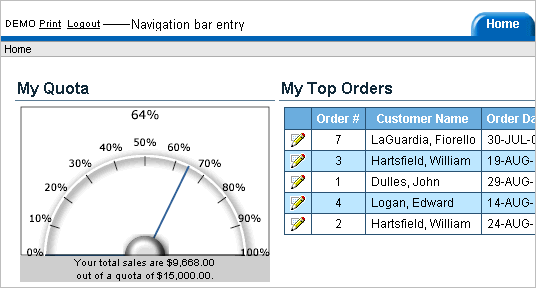

About Navigation Bars
A navigation bar entry can be an image, text, or an image with text beneath it. You must supply the images and text to use in the navigation bar entries.
Description of nav_bar_2.gif follows
Navigation bars are different from other shared components in that you do not need to reference them on a page-by-page basis. If your page template includes the #NAVIGATION_BAR# substitution string, the Application Express engine automatically includes any defined navigation bars when it renders the page.
How to Create a Navigation Bar Entry
