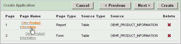

      Two new pages appear in the list at the top of the page. Note that each page has the same page name. Next, edit the page names to make them more meaningful.
  6. To edit the name of page 1:
    1. Click OEHR_PRODUCT_INFORMATION next to page 1 at the top of the page as shown in Figure 6-1.
      Figure 6-1 Page Name in the Create Application Wizard
      Description of Figure 6-1 follows
      Description of "Figure 6-1 Page Name in the Create Application Wizard"
    2. In Page Name, replace the existing text with Product Report.
    3. Click Apply Changes.

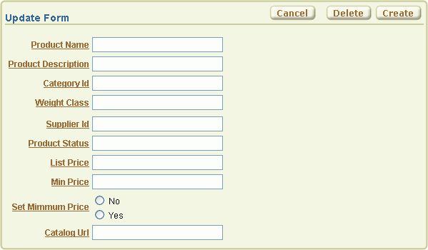

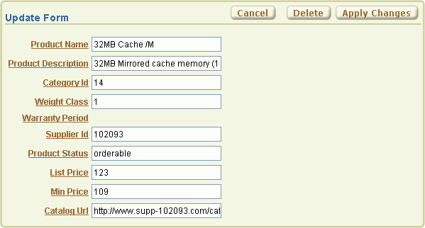

Run the Page
To run the page:
  1. Click the Run Page icon in the upper right corner.
  2. If prompted to enter a user name and password, enter your workspace user name and password and click Login. See "About Application Authentication".
    The revised form appears as shown in Figure 6-5. Note that the Warranty Period field no longer displays and a new Set Minimum Price radio group appears.
    Figure 6-5 Update Form with Set Minimum Price Radio Group
    Description of Figure 6-5 follows
    Description of "Figure 6-5 Update Form with Set Minimum Price Radio Group"

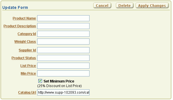

Edit the Item to Display as a Check Box
Next, change the Set Minimum Price radio group (P2_SET_MIN_PRICE) to display as a check box.
To edit P2_SET_MIN_PRICE:
  1. Click Edit Page 2 on the Developer toolbar.
    The Page Definition for Page 2 appears.
  2. Under Items, click P2_SET_MIN_PRICE.
  3. From Display As, select Checkbox.
  4. Scroll down to Label. In Label, delete the existing text, Set Minimum Price.
  5. Scroll down to Default. In Default Value, enter N.
  6. Under Lists of Values:
    1. Number of Columns - Enter 1.
    2. List of values definition - Enter:
      STATIC: <b> Set Minimum Price</b><br/> (25% Discount on List Price);Y
  7. Click Apply Changes at the top of the page.
Run the Page
To run the page, click the Run Page icon in the upper right corner. The revised form appears as shown in Figure 6-6. Note the new Set Minimum Price check box.
Figure 6-6 Update Form with Set Minimum Price Check Box

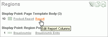

  3. Under Regions, click the Report link as shown in Figure 6-7.

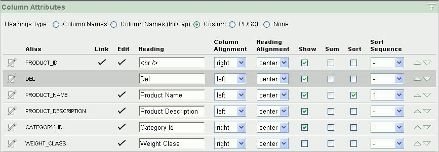

    The Report Attributes page appears. You can use this page to precisely control the report layout. First, change the number of columns that display.
  4. Deselect the Show check box for the following columns:
    • Weight Class
    • Warranty Period
    • Supplier ID

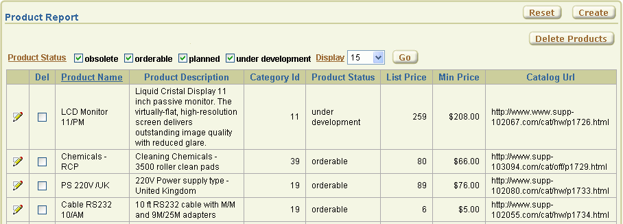

Create Multi Value Check Boxes to Filter Content
In the next exercise, you change the Search field (P1_REPORT_SEARCH) on the Product Report page to a multi value check box. These check boxes enable users to filter the report by product category (obsolete, orderable, planned, under development).
Topics in this section include:
Change the Search Field to a Multi Value Check Box
To change the search field to a check box:
  1. Click Edit Page 1 on the Developer toolbar.
    The Page Definition for page 1 appears.
  2. Under Items, click P1_REPORT_SEARCH.
  4. Scroll down to Label. For Label, delete the existing text and replace with Product Status.
  5. Scroll down to Source. In Source Value or Expression, enter:
    obsolete:orderable:planned:under development
  6. Scroll down to List of Values. Specify the following:
    1. Named LOV - Accept the default.
    2. Number of Columns - Enter 4.
    3. List of values definition - Enter:
      SELECT DISTINCT product_status display_value, product_status return_value
      FROM oehr_product_information
      ORDER BY 1
      Note that to create a multi value check box, the List of Values query must return more than one row.

  5. Scroll to the top of the page and select the Report Attributes tab.
  6. Under Column Attributes, locate the Del column.
  7. Click the Up arrow on the far right until the DEL column is directly below PRODUCT_ID. (See Figure 6-8).
    Figure 6-8 Report Column Attributes Page
    Description of Figure 6-8 follows
    Description of "Figure 6-8 Report Column Attributes Page"
  8. Click Apply Changes.

    Notice that the Delete Products button appears above the report as shown in Figure 6-9. To remove a product from the report, select the Del check box and then click Delete Products.
