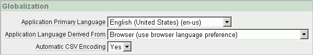

Under Globalization, specify the following:
Application Primary Language - Select the language you used when developing the application.
Application Language Derived From - Select Browser (use browser language preference).
This option enables users to view the application in the language specified in their browsers.
Automatic CSV Encoding - Select Yes or No.
Automatic CSV Encoding controls the encoding of all comma-delimited (CSV) report output in an application. If Automatic CSV Encoding is set to Yes, CSV report output is properly converted to a character set compatible with localized desktop applications. The character set for the CSV encoding is determined by the Application Language Derived From setting.

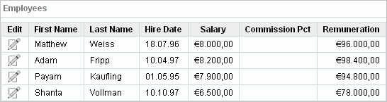

For example, the end user whose browser setting is German (de) sees these changes on the Employees page of AnyCo Corp:
The euro currency symbol appears for the amounts in the Salary and Remuneration columns.
The amounts reflect the formatting used in Germany (commas and decimals).
The Hire Date reflects the date format used in Germany.
