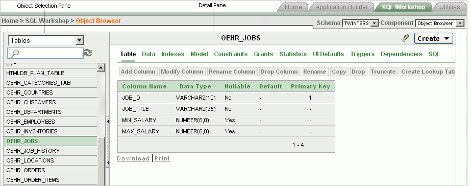

The Object Browser page is divided into two sections:
Description of o_brws.gif follows

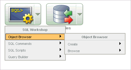

  3. To view Object Browser you can either:
    • Click SQL Workshop and then Object Browser to drill-down to the Object Browser.
    • Click the down arrow on the right side of the SQL Workshop icon to view a drop down menu. Then select the Object Browser menu option.
Description of o_brws_menu_apex.gif follows
For the purposes of consistency, this document uses the primary navigation path (or drill-down approach) when explaining navigation.

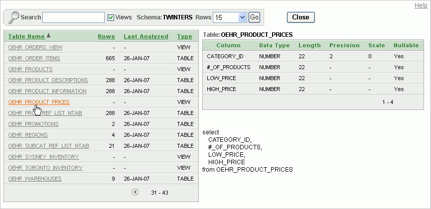

Using the Find Tables Icon
The Find Tables icon resembles a flashlight. Click this icon to view tables within the currently selected schema.
Description of wrkshp_find_tables.gif follows
To view tables within the current schema:
  1. Navigate to either Object Browser or SQL Commands.
  2. From the Schema list, select a schema (optional).
  3. Click the Find Tables icon.
    The Table Finder appears. A search bar displaying the selected schema displays at the top of the page and contains the following controls:
    • Search. Search for a table name. Enter case insensitive keywords in the Search field and click Go. To view all tables, leave the Search field blank and click Go.
    • Rows. Determine how many rows display in the resulting report. To change the number of rows that display, make a selection from the list and click Go.
    • Views. Select the Views check box and click Go to include views in the resulting report.
    The Table Finder report appears displaying the table name, the number of rows, last analyzed date, and the object type.
  4. Select a table name.
    Description of wrkshp_view_table.gif follows
    A table definition appears on the right side of the page.
    This report displays the column names, data type, length, precision, scale and the SQL necessary to re-create the table that appears at the bottom of the page.

To view a table description:
  1. On the Workspace home page, click SQL Workshop and then Object Browser.
    Object Browser appears.
  2. From the Object list, select Tables.
  3. From the Object Selection pane, select a table.
    The table description appears.
Summary of Available Views
Click the tabs at the top of the page to view different reports about the table. Table 1-1 describes all available views.
Table 1-1 Available Views for Tables
View Description
Table
Displays details of the first 31 columns including the column name, data type, nullable status, default value, and primary key. While viewing table details you can add, modify, delete, or rename a column. Additionally, you can drop, rename, copy, or truncate the table only if the referencing table has no records and create a lookup table.
To export the data as a comma-delimited file (.csv) file, click the Download link.
See Also: "Editing a Table"
