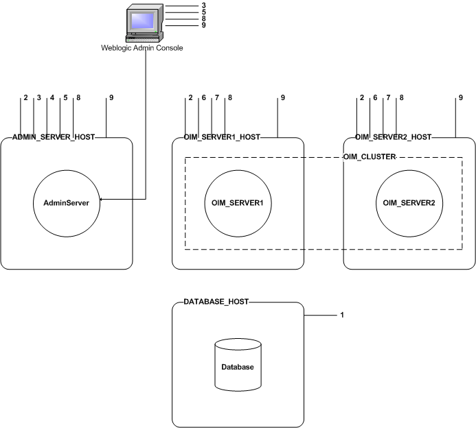

A clustered installation requires multiple host computers. The instructions in this chapter involve deployment and running of Oracle Identity Manager on four host computers. These instructions assume that you have four computers, of which one is used to host the Web server and the other is used to host the WebLogic Admin Server.
Table 5-1 describes the entities needed for a cluster, the computers that the entities run on, and the software required for the entities. Host computers and entities are labeled.
Table 5-1 WebLogic-Based Oracle Identity Manager Cluster Host Computers

Figure 5-1 Steps to Install WebLogic and Oracle Identity Manager in a Cluster
Installing WebLogic and Oracle Identity Manager in a clustered environment involves the following steps:
2. Installing WebLogic Server on ADMIN_SERVER_HOST, OIM_SERVER1_HOST and OIM_SERVER2_HOST
3. Configuring Oracle WebLogic Server for an Oracle Identity Manager Installation
5. Configuring OIM_SERVER2 in the AdminServer on ADMIN_SERVER_HOST
