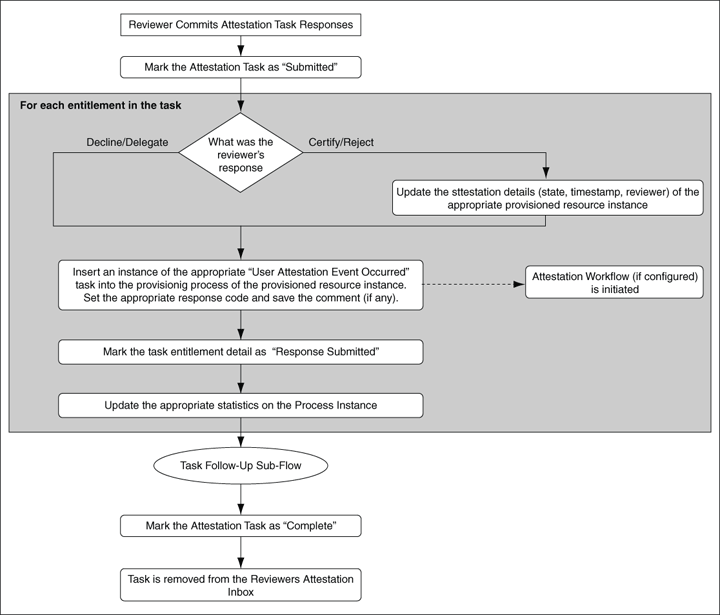

15.1.5.3 Stage 3: Processing a Submitted Attestation Task
The Attestation Task is marked as Submitted. At this point the attestation task is frozen, and cannot be acted on further. For each entitlement in the attestation task, the response is examined by the system. If the response is to either certify or reject, then the provisioned resource instance corresponding to that entitlement is updated accordingly. At the provisioned resource instance level, the last attestation result, the time at which last attestation occurred, and who the reviewer was are recorded. If the response is to decline or delegate, then the attestation detail at the provisioned resource level is not changed.
The User Attestation Event Occurred task is inserted into the provisioning process of the resource instance. This starts any attestation-driven workflows that may have been defined. Any comments are saved to the notes field of the task.
The attestation entitlement detail in the task is marked as Response Submitted. Figure 15-3 shows the flow of events after the attestation task response is submitted.
Figure 15-3 Flow of Events After Attestation Task Response Is Submitted
Description of Figure 15-3 follows
Description of "Figure 15-3 Flow of Events After Attestation Task Response Is Submitted"
The following statistics are updated on the process instance:
  • Number of entitlements certified
  • Number of entitlements rejected
  • Number of entitlements declined
  • Number of entitlements delegated

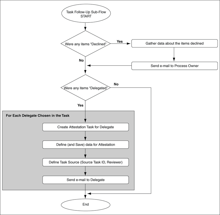

After all entitlements are covered, a subflow for follow-up action is initiated. In this flow, the process examines if the response for any of the entitlements in the task was declined. If there were any such entitlements, then the process sends e-mail to the Process Owner outlining the details of the decline action.
Next, the process examines if the response for any of the entitlements in the task was delegated. If there were any such entitlements, then the process identifies all the users that the reviewer selected as delegates and creates an attestation task for each. Each attestation task is only for the entitlements that the reviewer delegated to the user. The delegated user receives e-mail notification about the delegation.
After all the delegated attestation tasks are created, the subflow is completed and it merges back into the main flow. Figure 15-3 shows the flow of events of the follow-up action subflow.
Figure 15-4 Follow-Up Action Sub-Flow
Description of Figure 15-4 follows
Description of "Figure 15-4 Follow-Up Action Sub-Flow"
With the follow-up subflow complete, the attestation task is marked as Complete.

15.1.9.3 Notify Process Owner About Declined Attestation Entitlements
The Notify Declined Attestation Entitlements template is used to build the e-mail to send to process owners notifying them of any declined entitlement attestations.
15.1.9.3.1 Variables
The following are variables in the Notify Process Owner about Declined Attestation Entitlements template:
Variable Description
Attestation Request.Request Id ID of the attestation request
Attestation Definition.Process Name Name of the attestation process
Attestation Task.Reviewer First Name First name of the reviewer
Attestation Task.Reviewer Last Name Last name of the reviewer
Attestation Task.Reviewer User Id User ID of the reviewer
Attestation Data.Provisioned User First Name First name of the user being attested
Attestation Data.Provisioned User Last Name Last name of the user being attested
Attestation Data.Provisioned User User Id User ID of the user being attested
Attestation Data.Resource Name Name of the resource being attested
Attestation Data.Entitlement Descriptive Data Descriptive data of the entitlement being attested
15.1.9.3.2 Subject Line
The following is the Subject line of e-mail messages defined by the Notify Process Owner About Declined Attestation Entitlements template:
User access rights in attestation request Attestation Request.Request Id have been declined by Attestation Task.Reviewer User Id
15.1.9.3.3 Body
The following is displayed in the body of the message:
Attestation of the following user access rights were declined by the reviewer.
Reviewer: Attestation Task.Reviewer First Name Attestation Task.Reviewer Last Name [Attestation Task.Reviewer User Id]
Attestation Process: Attestation Definition.Process Name
Attestation Request ID: request Attestation Request.Request Id
Access Rights Data: Attestation Data.Provisioned User First Name Attestation Data.Provisioned User Last Name [Attestation Data.Provisioned User User Id] - Attestation Data.Resource Name - Attestation Data.Entitlement Descriptive Data
15.1.9.3.4 Special Comments
Each entitlement data item will appear on a new line.

15.5.2 E-Mail Notification
As part of the attestation process, the attestation engine sends e-mail to concerned parties at various stages. You can configure e-mail content by using e-mail templates of the General type in the Oracle Identity Manager Email Definition store.
In the templates, the form user is defined as XELSYSADM. You can change it to a different user. You must ensure that the e-mail address is defined for the user selected to use these templates. Otherwise, the system may not be able to send out notifications.
The following e-mail notification templates are available:
  • Notify Attestation Reviewer: Used for sending e-mail when an attestation task is assigned to a reviewer.
  • Notify Delegated Reviewers: Used for sending e-mail to reviewers when an attestation task is delegated to them.
  • Notify Declined Attestation Entitlements: Used for sending e-mail to users in the Process Owner group if a reviewer declines any entitlements.
  • Attestation Reviewers With No E-Mail Defined: Used for sending e-mail to users in the Process Owner group if an e-mail address is not defined for any of the reviewers.
