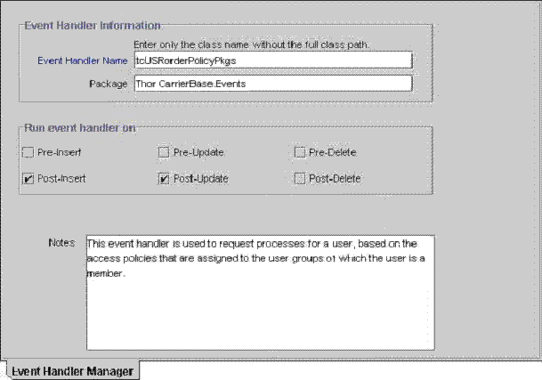

By using the Event Handler Manager form, you can specify when you want Oracle Identity Manager to trigger an event handler. An event handler can be scheduled to run as follows:
Pre-Insert: Before information is added to the database
Pre-Update: Before information is modified in the database
Pre-Delete: Before information is removed from the database
Post-Insert: After information is added to the database
Post-Update: After information is modified in the database
Post-Delete: After information is removed from the database
Figure 9-1 shows the Event Handler Manager form.
Table 9-1 describes the fields of the Event Handler Manager form.

The following sections describe how to create and modify event handlers.
To use an event handler, you must attach it to a data object by using the Data Object Manager form. For more information about assigning event handlers to data objects, see "Data Object Manager Form".Caution:
Any event handler that begins with the lettersadp
is associated with adapters, and should not be modified. However, you can modify system event handlers. These event handlers begin with the letters tc
.Adding or Modifying an Event Handler
To add or modify an event handler:
Open the Event Handler Manager form.
To add an event handler to Oracle Identity Manager, enter the name of the event handler into the Event Handler Name lookup field.
To modify an event handler, double-click the Event Handler Name lookup field.
From the Lookup dialog box that is displayed, select the event handler that you want to edit.
In the Package field, add or edit the name of the Java package of which the event handler is a member.
Select the check boxes that correspond to when you want Oracle Identity Manager to trigger the event handler.
You can schedule an event handler to run on preinsert, preupdate, predelete, postinsert, postupdate, and postdelete.
Selecting a check box does not mean that the event handler is triggered at that time, for example, on preinsert. It signifies that the event handler can run at that time.In the Notes area, add or edit explanatory information about the event handler.
Click Save.
The event handler is added or modified.

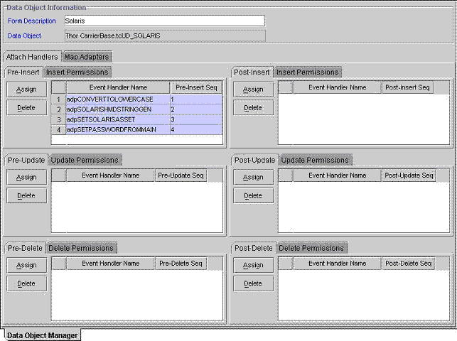

The Data Object Manager form is displayed in the Development Tools/Business Rule Definition folder. You use this form to:
Assign a rule generator adapter, entity adapter, or an event handler to an object that can add, modify, or delete data in the database. This type of object is known as a data object.
Schedule the adapter or event handler to run according to a schedule (pre-insert, pre-update, pre-delete, post-insert, post-update, or post-delete).
Organize the order in which Oracle Identity Manager triggers adapters or event handlers that belong to the same execution schedule.
View the user groups that can add, modify, and delete the current data object.
Map the variables of an adapter to their proper source and target locations.

Table 9-2 describes the fields of the Data Object Manager form.
Table 9-2 Fields of the Data Object Manager Form
Fields | Description |
Form Description |
The name of the form that is associated with the data object. |
Data Object |
The name of the data object to which you are assigning event handlers rule generator adapters, or entity adapters. |
The following section describes how to select the target data object to which a rule generator adapter, entity adapter, or event handler will be assigned.
Selecting a Target Data Object
To select a target data object:
Open the Data Object Manager form.
Double-click the Form Description field.
From the Lookup dialog box that is displayed, select the name of the form that is associated with the data object to which you want to assign an event handler, rule generator adapter, or entity adapter.
After you select a form, the name of the corresponding data object is displayed in the Data Object field.
Click Save.
The target data object is selected. You can now assign rule generator adapters, entity adapters, and event handlers to it.
After you start the Data Object Manager form and select a target data object, the tabs of this form become functional.
The Data Object Manager form contains the following tabs:
Attach HandlersMap Adapters
Each of these tabs is described in the following sections.
You use this tab to select the rule generator adapters, entity adapters, or event handlers that will be assigned to or removed from a data object. This includes the following:
Specifying when Oracle Identity Manager triggers the assigned event handlers or adapters (on pre-insert, pre-update, pre-delete, post-insert, post-update, or post-delete).Setting the order in which Oracle Identity Manager triggers the adapters or event handlers that belong to the same execution schedule.
When an event handler, rule generator adapter, or entity adapter must no longer be triggered by Oracle Identity Manager, you must remove it from the data object.
For example, Oracle Identity Manager can trigger the adpCONVERTTOLOWERCASE
, adpSOLARISHMDSTRINGGEN
, adpSETSOLARISASSET
, and adpSETPASSWORDFROMMAIN
adapters on pre-insert. Based on the sequence numbers of these adapters, Oracle Identity Manager triggers the adpCONVERTTOLOWERCASE
adapter first, followed by the adpSOLARISHMDSTRINGGEN
adapters, respectively.
To see the user groups that can add, modify, and delete the current data object, click the Insert Permissions, Update Permissions, or Delete Permissions tabs, respectively.The following sections discuss these procedures:
Assigning an event handler, rule generator adapter, or entity adapter to a data objectOrganizing the execution schedule of event handlers or adaptersRemoving an event handler, rule generator adapter, or entity adapter from a data object
To assign an event handler or adapter:
Select the tab of the Data Object Manager form that represents when you want the adapter or event handler to be triggered.
For example, if you want Oracle Identity Manager to activate an adapter on pre-insert, select the Pre-Insert tab.
From the selected tab, click Assign.
The Assignment dialog box is displayed.
Select the event handler or adapter, and assign it to the data object.
Click OK.
The event handler or adapter is assigned to the data object.
To organize the execution schedule:
Select the event handler or adapter whose execution schedule you want to change.
Click Assign.
Select the event handler or adapter.
If you click Up, the selected event handler or adapter will switch places and sequence numbers with the event handler or adapter that precedes it.
If you click Down, the selected event handler or adapter will switch places and sequence numbers with the event handler or adapter that follows it.
Repeat Steps 3 and 4 until all event handlers and adapters have the appropriate sequence numbers.
Click OK.
The event handlers and adapters will now be triggered in the correct order for the execution schedule or schedules that you organized.
