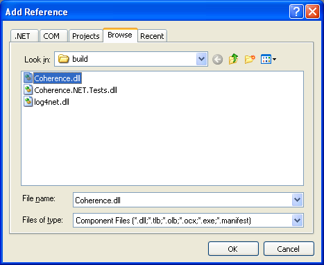

To use the Coherence for .NET library in your .NET applications, you must add a reference to the Coherence.dll library in your project and create the necessary configuration files.
Creating a reference to the Coherence.dll:

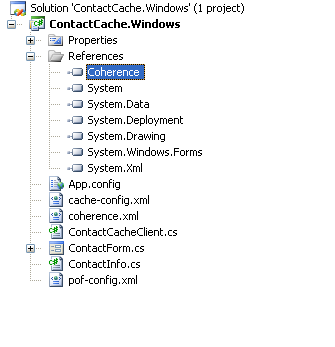

Next, you must create the necessary configuration files and specify their paths in the application configuration settings. This is done by adding an application configuration file to your project (if one was not already created) and adding a Coherence for .NET configuration section (i.e. <coherence/>) to it.
<?xml version="1.0"?> <configuration> <configSections> <section name="coherence" type="Tangosol.Config.CoherenceConfigHandler, Coherence"/> </configSections> <coherence> <cache-factory-config>my-coherence.xml</cache-factory-config> <cache-config>my-cache-config.xml</cache-config> <pof-config>my-pof-config.xml</pof-config> </coherence> </configuration>
Elements within the Coherence for .NET configuration section are:
Having added these configuration files, your solution should look like:
