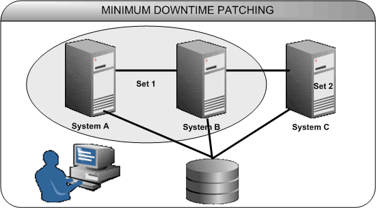

minimize_downtime
Specifies the order of nodes that OPatch should patch.
This option only applies to Oracle Real Application Clusters environments. You cannot use it with the -local option with a rolling patch.

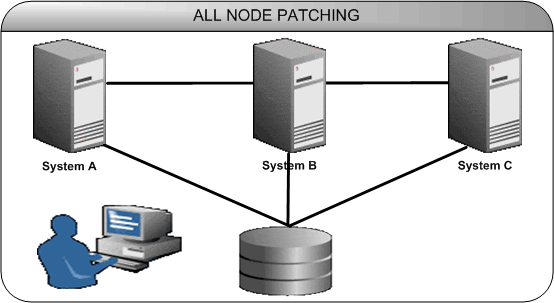

All Node Patching
Figure 7–1 shows a basic example of All Node Patching.
Figure 7-1 All Node Patching
Figure illustrating all node patching, in which systems A, B, and C converge
Systems A, B, and C are nodes in this cluster. When you perform All Node Patching in this cluster, you bring down systems A, B, and C, apply patches to all these nodes, then bring systems A, B, and C back up again.

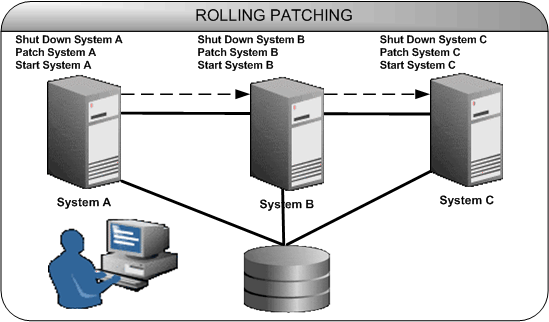

Rolling Patching
In Rolling Patching, you shut down each node, apply the patch, then bring up each node again. You do this separately for each node until you patch all nodes in the cluster. This is the most efficient method of applying an interim patch to an Oracle Real Application Clusters setup, because there is absolutely no downtime during the application of patches, as only one system is brought down at any given time. Only some patches can be applied in this mode. The type is generally specified in the patch metadata.
Figure 7–2 shows a basic example of Rolling Patching.
Figure 7-2 Rolling Patching
Figure illustrating rolling patching in which systems A, B, and C are sequentially shut down and restarted.
When you perform Rolling Patching in this cluster, the patches are applied in a rolling fashion. You initially bring down system A, apply a patch to it, then bring it back up. You do the same thing for systems B and C.
Minimum Downtime Patching
In Minimum Downtime Patching, the nodes are divided into sets. Initially, you shut down the first set and apply a patch to it. After this, you shut down the second set. You then bring up the first set and apply a patch to the second set. You now bring up the second set. All the nodes in the cluster are now patched. This method leads to less downtime for Oracle Real Application Clusters when both sets are brought down. This mode is executed by using -minimize_downtime command line option. You can also activate this option from the response file.
Figure 7–3 shows a basic example of Minimum Downtime Patching.
Figure 7-3 Minimum Downtime Patching
Figure illustrating minimum downtime patching, which shows the interaction between systems A, B, and C
Systems A, B, and C are nodes in this cluster. It is divided into two sets: Set 1 contains systems A and B, and Set 2 contains system C. When you perform Minimum Downtime Patching in this cluster, you shut down Set 1 and apply a patch to it. You now shut down Set 2. Then, you bring up Set 1 and apply a patch to Set 2. After you apply the patch, you bring up Set 2 again. Now both Sets 1 and 2 are patched.
