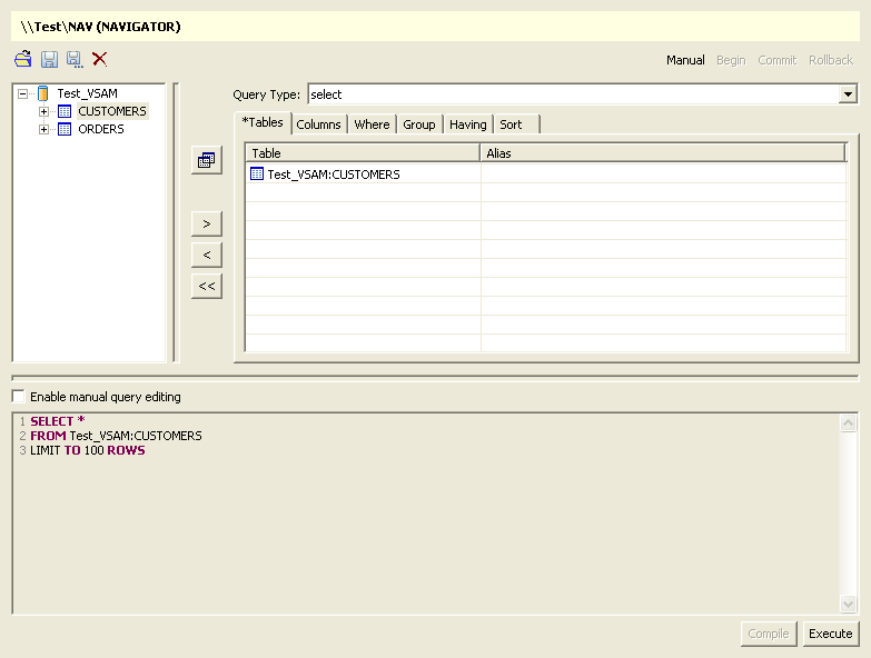

  5. Right-click the required data source entity, and select Query Tool.
    The Query Tool opens in the Editor pane, with the Build Query tab displayed (see Figure 4-1).
  6. Select Navigator and click OK.
  7. Select the required query type from the Query Type list. The default is a SELECT-type query.
  8. Locate and expand the node of the required data source entity.
    The data source tables are listed.
  9. Select the required table and move it to the Table column by using the arrow button.
    Figure 4-1 The Query Tool Screen
    Query tool screen
    Description of "Figure 4-1 The Query Tool Screen"
  10. Click Execute query.
    The Query Result tab opens, displaying the results of the query.
