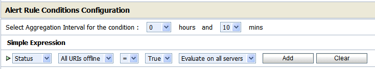

In addition to configuring a business service to take a non responsive URI offline, as described in Section 46.2, "How to Mark a Non-Responsive URI Offline" you can raise an alert when a system encounters non-responsive URIs. You do this by configuring SLA alert rules based on endpoint URI status.
You can configure the alert rule for a business service, based on the status of the Endpoint URI. Complete the tasks as described in Section 25.23.1, "Configuring General Information for Alert Rules."
Then complete the following tasks in the Alert Rule Conditions Configuration page, shown in Figure 46-1.
Figure 46-1 Alert Rule Condition Configuring page
In the Simple Expression section of the Alert Rule Conditions Configuration page, choose Status in the first list.
The endpoint URI status based alert rule condition is comprised of:
A state transition clause–The state transition clause supports notification when any endpoint URI or all endpoint URIs change state from online to offline, or from offline to online. Choose one of the following options to identify the status for which you want to create a notification:
All URIs offline
All URIs online
Any URI offline
Any URI online
For example, consider a business service for which two alert rules are configured, one based on All URIs offline = True
condition and another on Any URI offline = True
condition. If an alert based on All URIs offline = True
condition is generated then it signifies a severe problem because all requests to this service are likely to fail until the situation is resolved.
However, if an alert based on Any URI offline = True
is generated, it implies that the other endpoint URIs are responsive and subsequent requests may not fail.
All alert rules are independently evaluated. If alerts based on both (any or all URI) clauses have been configured for the same business service, it is likely that both alerts are generated simultaneously when the last endpoint URI is marked offline.If a business service has only one URI, the All URIs offline = True
and Any URI offline = True
clauses mean the same thing and so they behave in an identical manner.
The evaluation of an alert rule condition based on a transition from offline to online behaves in a similar fashion except that it tracks any or all endpoint URIs being marked back to online state.
A server clause–The server clause allows you to specify an alert trigger when a state transition occurs on any or all servers. The server clause is significant only in a cluster domain with multiple managed servers. Choose one of the following options to create the expression:
Evaluate on all servers
Evaluate on any server
A communication error can occur due to network problem on a machine hosting a managed server. Such an event is interpreted by the business service as the endpoint URI being non-responsive (although the remote endpoint being accessed is responsive). A communication error can also occur because the endpoint URI is not responding.
In the first case, the URIs are marked offline on only one server (on the machine with network problems) and online on all the other servers in the cluster. An alert condition based on Evaluate on any server
clause generates an alert, but an alert condition based on the Evaluate on all servers
clause does not generate an alert.
For the second case, the URI is marked offline on all the managed servers (one by one as each server tries to access that endpoint). As each managed server marks the endpoint URI offline, the alert rule condition based on Evaluate on any servers
is met and an alert is generated. When the endpoint URI is marked offline on the last of the servers in the cluster domain, the alert rule condition based on Evaluate on all servers
is also met and this alert is also generated.
Notes:
All alert rules are independently evaluated. If you have configured alerts based on both (any or all server) clauses for the same business service, it is likely that both alerts are generated simultaneously when the endpoint URI is marked offline on the last server in the cluster.In a single server domain, the Evaluate on any server
and Evaluate on all servers
clauses mean the same thing and behave in an identical manner.
When designing the alert rules for your system, you must choose one or more combinations of the clauses in accordance with your requirements.
You must set any one of the conditions to be True or False. These conditions can be evaluated on all servers or any server in a cluster.
To ensure that you do not miss any alert that is triggered due to frequent changes in the status of the URI, Oracle recommends that you set the aggregation interval for alert rules based on the status of the URI to one minute. For more information on aggregation interval, see Section 44.2, "Aggregation Intervals."
