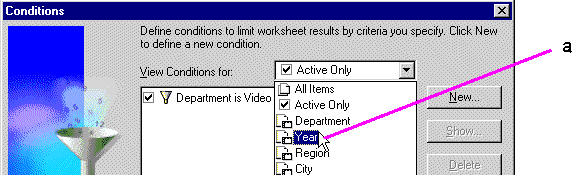

5.1.1 Viewing Tool Definitions for Specific Items
When creating a tool definition, you select whether to assign it to all data items or to a single item. Use the View drop-down menu to see the definitions assigned to various items, (see Figure 5-3 below).
Figure 5-3 Choosing which definitions to display in the Conditions dialog box
Surrounding text describes Figure 5-3 .
To see definitions for different items:
  1. Click the down-pointing arrow in the View drop-down list.
  2. Select one of the items on the list.
The list of definitions in the dialog box pertain to the selected item in the drop-down list. To see all of the definitions for the worksheet, choose All Items. To see only those currently turned on, choose Active Only.
Figure 5-4 Choosing definitions that apply to specific Items
Surrounding text describes Figure 5-4 .
Key to Figure 5-4:
a. Here, only conditions that apply to the Year Item will be displayed.

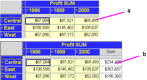

5.3 Totaling Numeric Data
When working with numeric items, you often want to see various types of summations of the data. Using the Totals tool you can sum rows and columns of numbers, find averages and standard deviation, compute subtotals and Grand Totals, and so on. The Totals tool automatically places the summations at the appropriate positions on the display.
Here are some examples:
Figure 5-15 A Crosstab Total on Worksheet Rows
Surrounding text describes Figure 5-15 .
Key to Figure 5-15:
a. An ordinary Crosstab Worksheet.
b. The same Crosstab Worksheet with a Total on rows, which calculates a grand total for each Region (Central, East, and West) for 1998, 1999, and 2000.

  3. Click OK. Discoverer Desktop now computes the totals and displays them on the table or crosstab.
To remove the totals from the data:
  1. Choose Tools | Totals.
    The Totals dialog box appears.
  2. Click the selected check box(es).
  3. Click OK. The totals are removed from the table or crosstab.
5.3.1 Creating a New Totals Definition
Creating a new totals definition has four basic steps:
  • Selecting the totals to calculate.
  • Selecting the type of total and where to place it on the table or crosstab.
  • Creating a label for the totals column or row.
  • Defining the format for the totals column or row.
To create a new totals definition:
    The Totals dialog box appears (Figure 5-18).
  2. Click the New button.
    The Total dialog box for a new totals appears.

To see conditions for specific data items:
  1. At the Conditions dialog box, choose an item from the drop-down list, View Conditions For. You can display all the conditions defined in a workbook, or only those that apply to particular data items.
    • To see conditions that apply to a specific data item, click the drop-down button and select a data item to see its conditions.
    • To see all of the conditions defined for the workbook, choose All Items.
    • To see only those conditions currently turned on, choose Active Only.
    Figure 5-33 View Conditions for a Specific Data Item
    Surrounding text describes Figure 5-33 .
    Key to Figure 5-33:
    a. Choose a data item to see its condition.

    Figure 5-38 Conditions Dialog Box
    Surrounding text describes Figure 5-38 .
    Key to Figure 5-38:
    a. The selected check box indicates that this condition is active.
    b. This condition is selected.
