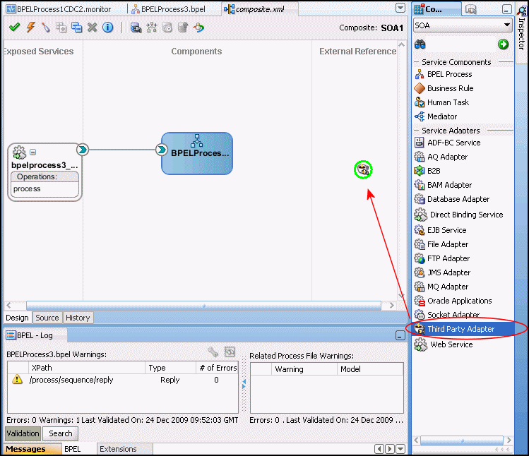

From the Projects area, on the left side, double-click the composite.xml
. At the bottom of the visual editor, click the Design tab, if necessary. Figure 6-3 shows the Composite View in the visual editor:
Drag a third-party adapter into External References lane of the visual editor, as shown in Figure 6-4.
When you drag the third-pary adapter into JDeveloper the Create Third Party Adapter Service screen is displayed as shown in figure Figure 6-5.

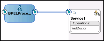

In the Composite, connect the BPEL process to the third-pary adapter as shown in Figure 6-7.

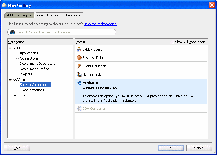

Right-click the SOA project and select New. The New Gallery is displayed as shown in Figure 6-10.
In the Categories list, expand SOA Tier and select Service Components.
From the Items list, select Mediator and click OK. The Creator Mediator screen is displayed as shown in Figure 6-11.
Enter the following in the Create Mediator screen:
Enter a Name, for example MEDOUTBOUND1.
Select a Synchronous Mediator Template.
Click OK. The Mediator is dislpayed in the visual editor.

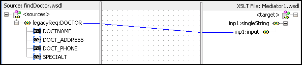

Click the singleString_To_Doctor
tab. Connect the Doctor
element fromthe source:findDoctor.wsdl
to the inp1:input
element in the Mediatorx.wsdl
as shown in Figure 6-19.

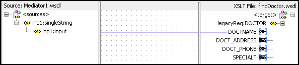

Click the Doctor_To_singleString
tab. Connect the inp1:input
element fromthe source:Mediatorx.wsdl
to the DOCTOR
attribute in the findDoctor.wsdl
as shown in Figure 6-20.
