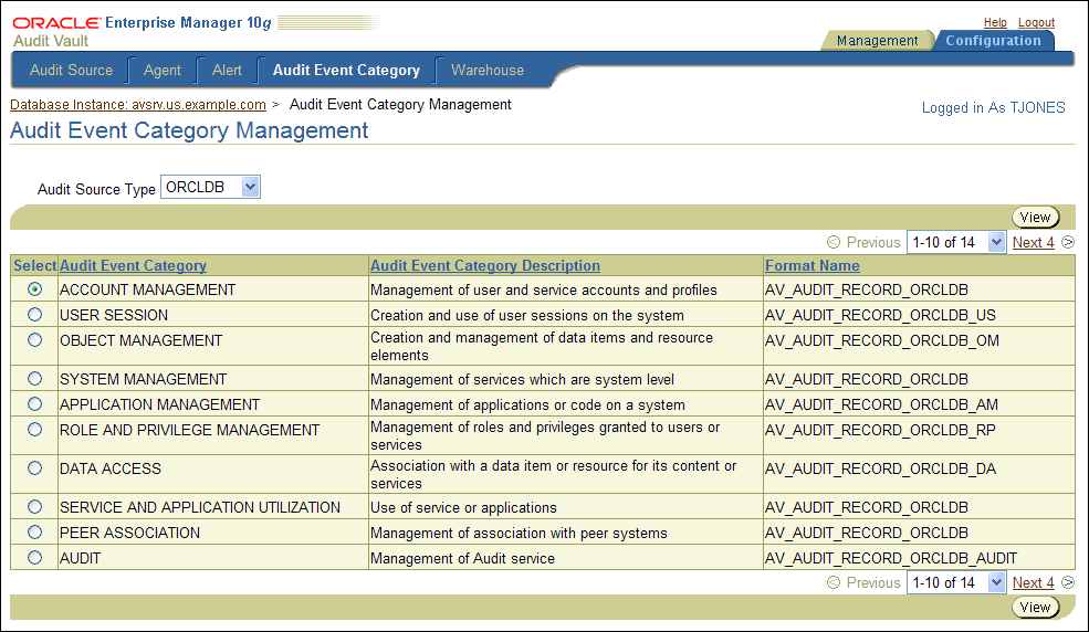

3.2.6 Viewing Audit Event Categories
Audit event category management consists of viewing the Oracle Audit Vault audit event categories, their attributes, and their audited events. An audit event category defines how various types of events are organized. For example, invalid records are placed in the Invalid Record event category. See Oracle Audit Vault Auditor's Guide for more information about audit event categories.
  1. Log in to the Audit Vault Console as a user who has been granted the AV_ADMIN role.
    See Section 3.2.3 for login instructions.
  2. Select the Configuration tab, and then select the Audit Event Category subpage.
    The Audit Event Category Management page appears.
  3. Select an audit event category, and then click View to find detailed information about that category.
    The View Audit Event Category page appears.
  4. From the Audit Source Type list, select from the available source types: ORCLDB, MSSQLDB, SYBDB, and DB2DB.
  5. Select the Attributes or Audit Events subpages to view detailed information about these categories.
  6. Click OK when you complete viewing the audit event information for the category you selected.
Figure 3-1 shows the Audit Event Category Management page.
Figure 3-1 Audit Event Category Management Page
Description of Figure 3-1 follows
Description of "Figure 3-1 Audit Event Category Management Page"
On the Audit Event Category Management page, audit event categories appear in a table with the following columns:
  • Audit Event Category
  • Audit Event Category Description
  • Format Name
  • Format Module

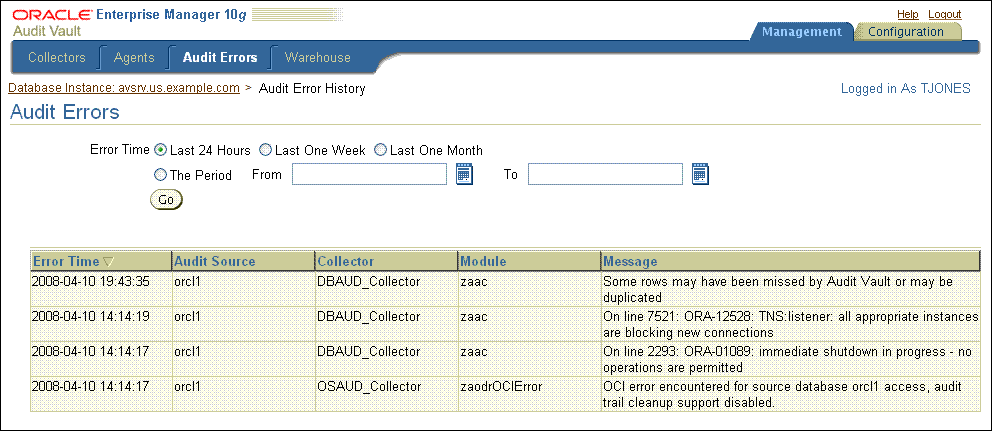

3.2.7 Viewing Operational Errors That Oracle Audit Vault Catches
You can use the Audit Vault Console to view operational errors that Oracle Audit Vault catches, such as broken database connections and missing files.
To view errors using Oracle Audit Vault:
  2. Select the Management tab, and then select the Audit Errors subpage.
    The Audit Errors page appears.
  3. After the Error Time label, specify a time range of errors to view.
    Select from the Last 24 Hours, Last One Week, or Last One Month options to view errors from those times, or select The Period and then enter a start date in the From field and end date in the To field to specify a different time range.
  4. Click Go.
Figure 3-2 shows the Audit Errors page with audit errors from the last 24 hours.
Figure 3-2 Audit Errors Page
Description of Figure 3-2 follows
Description of "Figure 3-2 Audit Errors Page"
The Audit Errors page displays error information as a table with the following column headings:
  • Error Time: Local time when the audit error was generated
  • Audit Source: The audit source database on which the audit error originated
  • Collector: The collector on which the audit error originated
  • Module: The module name involved in the audit error
  • Message: The content of the audit error message

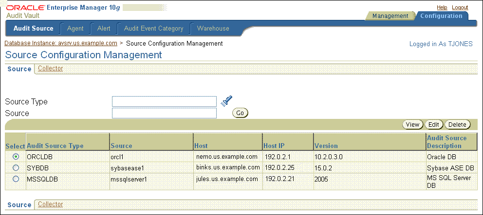

3.3.2 Altering Collector Properties and Attributes Using the Audit Vault Console
To alter collector properties and attributes using the Audit Vault Console:
  2. Select the Configuration tab, and then select the Audit Source subpage.
    The Source Configuration Management page appears.
  3. Select the Collector subpage.
    The Collector Configuration Management page appears, which displays the current settings for the available collectors.
  4. Select the collector that you want to modify, and then click the Edit button.
    The Edit Collector page appears.
  5. Under Attributes, modify the attributes for the collectors by editing the values in the Value column.
    For more information about these attributes, see the following sections:
  6. Click OK.

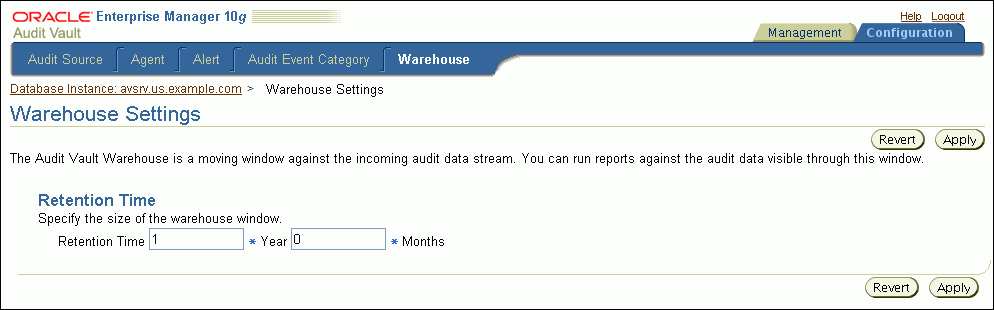

3.4.2.2 Creating a Retention Period Using the Audit Vault Console
To create the retention period using the Audit Vault Console:
  2. Select the Configuration tab, and then select the Warehouse subpage.
    The Warehouse Settings page appears.
    Data Warehouse management
  3. Set the retention window, that is, the period of time during which the data sent to the Oracle Audit Vault data warehouse remains in storage.
    For example, suppose that you want to keep the audit data in storage for the next year and a half. To do so, you would enter 1 in the Year field and 6 in the Months field.
  4. Click Apply.

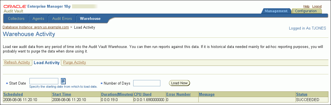

3.4.3 Loading Data to the Oracle Audit Vault Data Warehouse
This section contains:
3.4.3.1 About Loading Data into the Oracle Audit Vault Warehouse
You can load data that is older than the retention period from the raw audit data store into the Oracle Audit Vault data warehouse tables. After you load this data, it is available to auditors to generate reports or perform analysis.
To find the current retention period setting, view the Warehouse Settings page of the Audit Vault Console (see Section 3.4.2).
3.4.3.2 Loading Data Warehouse Data Using the Audit Vault Console
To load the data warehouse data using the Audit Vault Console:

  3. Select the Management tab, and then select the Warehouse subpage.
    The Warehouse Activity page appears.
  4. Select the Load Activity subpage.
    The Load Activity page appears.
    Description of warehouse_load.gif follows
  5. In the Start Date field, enter the beginning date of the data that you want to load. For example, suppose the source database contains audit data that is 10 years old, and you want to load the last 5 years worth of audit data into the Oracle Audit Vault data warehouse. Assuming that today's date is August 8, 2008, you would specify August 8, 2003 as the start date.
  6. In the Number of Days field, enter the number of days, starting from the start date, through which you want to load data.
  7. Click the Load Now button.
    Oracle Audit Vault schedules the data load operation, which is listed on this page the next time you access it.
  8. Reenable the alert settings if you had disabled them.
    See Section 3.2.5 for more information.
  3. Select the Source subpage.
    The Source Configuration Management page displays the current settings for the available collectors.
    Description of srcconfigmgmt.gif follows
  4. Select the source database that you want to modify, and then click the Edit button.
    The Edit Source page appears.
  5. Under Properties, optionally modify the description of the source database.
  6. Under Attributes, modify the attributes for the source database by editing the values in the Value column.
    • Section 8.5 for the Oracle Database source database attributes
    • Section 9.5 for the SQL Server source database attributes
    • Section 10.5 for the Sybase ASE source database attributes
    • Section 11.5 for the IBM DB2 source database attributes
  7. Click OK.
