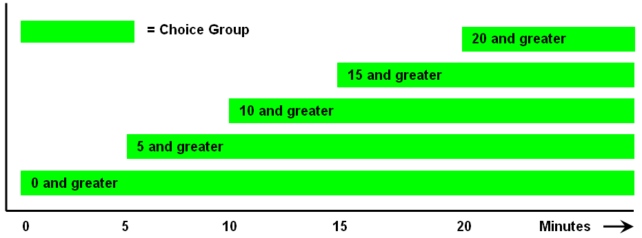

For predicting numeric values, Oracle RTD utilizes a method based on quantile regression and overlapping threshold techniques. The key component consists of choices whose values are equally spaced, overlapping numeric ranges. Users can configure the ranges as dynamic choices by supplying application parameters. For more details of these parameters, see Section 7.2, "Application Object."
As an example, with the application parameter Min Output set to 0, Spacing set to 5, and Max Output set to 20, the following dynamic choices are configured:
0 and greater
5 and greater
10 and greater
15 and greater
20 and greater
For each web session, as the session closes, the value for the total duration is passed to Oracle RTD. The Inline Service is configured to update the model for each of the choices that the session duration falls into. So if the session duration is 17 minutes, the choices, "0 and greater", "5 and greater", "10 and greater", and "15 and greater" will all have their associated models updated. This learning pattern is repeated for each session.
When a duration prediction is requested, based on session attributes, Oracle RTD provides a likelihood of occurrence for each of the choices. Oracle RTD then determines how many choices have a likelihood greater than a given minimum value - this minimum value is supplied by users as an application parameter Choice Likelihood Threshold, whose default value is 0.5.
For each choice where the likelihood is above the minimum value, Oracle RTD then applies the formula:
Prediction value of a numeric target = (Number of the dynamic choices that meet the minimum choice likelihood) * (Spacing between the choices) + (Minimum value for the target number)
Following the example, if four of the choices have a likelihood greater than the Choice Likelihood Threshold, the formula calculates the predicted value as:
4 (number of above threshold choices) * 5 (choice spacing) + 0 (minimum value) = 20
From this, it should be clear that the more narrow the spacing, the more precise the numeric prediction can be, assuming that there is enough data to learn on.

For predictions, the quantile regression method relies on overlapping buckets of numeric ranges to be modeled, where a median number is determined based on the most likely buckets for any given prediction. For the same example range of 0-100, an overlapping scheme with a spacing of 10 results in dynamic choice groups with the following values:
"0 and above"
"10 and above"
"20 and above"
up to "90 and above." So, if the session resulted in a number of 25 to be modeled, the choice groups, "0 and above," "10 and above," and "20 and above" will each be updated accordingly.
With these dynamic choices of overlapping buckets, a prediction algorithm can then be applied based on the most likely choices to determine the final numeric value. In the Numeric_Prediction_ECommerce Inline Service, this is achieved by the Get Numeric Prediction function.

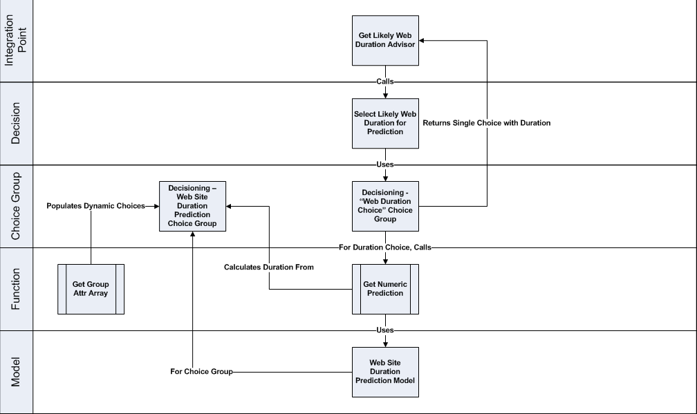

This section shows the workflows for the Numeric_Prediction_ECommerce Inline Service integration points and the Inline Service elements used during the processing of the integration points.
Figure 7-1 shows the workflow and elements associated with each informant in the Numeric_Prediction_ECommerce Inline Service. Note that the "learning" logic is included as part of the Close Session informant processing, which updates the following models:

Figure 7-2 shows the workflow for the advisor Get Likely Web Duration in the Numeric_Prediction_ECommerce Inline Service.
The processing behind the Get Likely Web Duration advisor shown in Figure 7-2 is as follows:
The Get Likely Web Duration advisor calls the decision Select Likely Web Duration for Prediction, which uses the Decisioning choice group Web Duration Choice
The Decisioning choice group Web Duration Choice calls the function Get Numeric Prediction
The function Get Numeric Prediction calculates the numeric prediction against the Decisioning choice group Web Site Duration Prediction for the model Web Site Duration Prediction Model
The Decisioning choice group Web Site Duration Prediction has its dynamic choices populated by the function Get Group Attr Array

The following advisor is configured in the Numeric_Prediction_ECommerce Inline Service:
In the Numeric_Prediction_ECommerce Inline Service, the advisor Get Likely Web Duration together with the three informants Initiate Session, Identify Customer, and Close Session, form a subset of the integration points found in the Base E-Commerce solution. They are used by the included loadgen scripts to create the simulated learnings that demonstrate the numeric prediction capabilities.
For more details about the Integration Point processing in the Numeric_Prediction_ECommerce Inline Service, see Section 7.6, "Integration Point Workflows."The advisor Get Likely Web Duration returns a single choice, Web Duration, whose attribute Web Duration contains the predicted numeric value for web duration for the given session inputs.
Table 7-10 describes the parameters for the advisor Get Likely Web Duration.
Table 7-10 Advisor Get Likely Web Duration
| Parameter | Description |
Advisor Name |
Get Likely Web Duration |
Session Keys |
Session / Current Web Interaction / Interaction Id |
Request Data |
Address State Province (String) mapped to Customer.AddressStateProvince Customer Id (String) mapped to Customer.Customer Id Gender (String) mapped to Customer.Gender Industry (String) mapped to Customer.Industry Marital Status (String) mapped to Customer.Marital Status |
External System |
CRM System |
Order |
0 |
Force session close |
No |
Decision |
Select Likely Web Duration for Prediction |
Group Decision |
Default Choices |
None |
Logic |
None |
Pre-condition |
None |
Table 7-11 describes the parameters for the decision for the advisor Get Likely Web Duration.
Table 7-11 Decision for Advisor Get Likely Web Duration
Decision Name |
Select Choices From |
Web Duration Choice |
Number of Choices to Select |
1 |
Select at Random |
No |
Target Segments |
Default |
Priorities for Default Segment |
Maximize Likelihood 100% |
Pre Selection Logic |
None |
Post Selection Logic |
None |
Two models are included in the Numeric_Prediction_ECommerce Inline Service. The first model, Web Site Duration Model, is used for the analysis-based choice group while the second model, Web Site Duration Prediction Model, is used for the prediction based model.
For more information about how the models are used in the Numeric_Prediction_ECommerce Inline Service, see Section 7.6, "Integration Point Workflows."The functions included in Numeric_Prediction_ECommerce Inline Service are used for learning the dynamic choice buckets and for applying the scoring algorithm for predicting a number.
