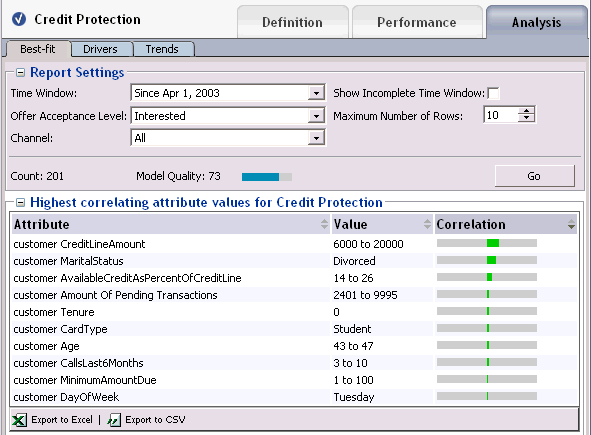

Section 3.9, "Analytic Reports and the Oracle RTD Decision Center"

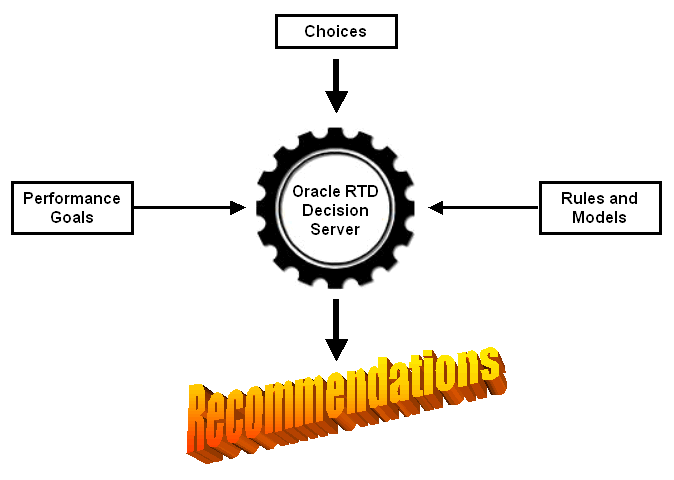

Oracle RTD Decision Making Features Overview
The overall principles and underlying elements described in the job hunting example are incorporated as basic features of Oracle RTD, as shown in the following table:
| Questions in the Decision Making Process | Oracle RTD Features |
| What are your choices? | Choices |
| What are your goals? | Performance Goals |
| What are your criteria for evaluating those goals? | Rules and Models |
The following diagram shows a high-level overview of how these features interact to fulfill the basic objective of Oracle RTD, namely to provide recommendations from a number of alternatives or choices.
For more information on these features and how to use them in Oracle RTD, see the following sections:

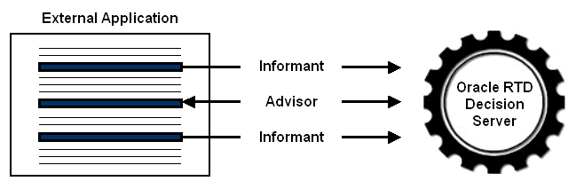

In general, Oracle RTD connects with other applications, and passes its recommendations to these external applications. See the next section for more information about how Oracle RTD integrates with external applications.
Applications that you develop to interact with Oracle RTD are referred to as external applications. Typically external applications consist of many processing steps and stages. The points at which external applications communicate with Oracle RTD are generically known as Integration Points.
There are two main types of Integration Point:
An Informant is a process that passes data from the external application to Oracle RTD
An Advisor is a two-way process, that both passes data from the external application to Oracle RTD, and also receives data sent back from Oracle RTD to the external application
Advisors are the main method by which an external application requests and receives recommendations from Oracle RTD.
Each external application can have many Informants and Advisors.

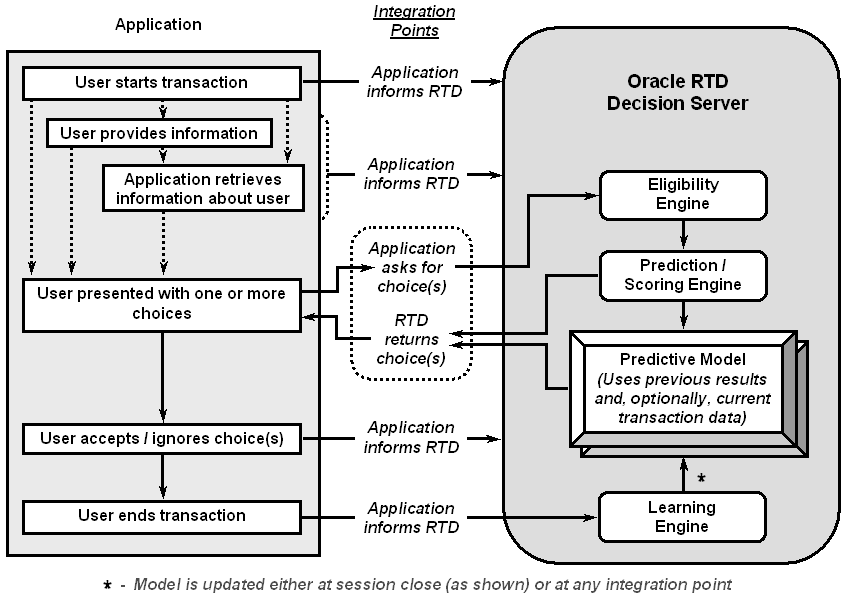

Many applications are based on a dialog with a user, which leads to the application presenting alternative strategies or choices to the user.
Typically, the dialog between the application and the user proceeds as follows:
The user starts a transaction.
The application retrieves information about the user.
Optionally, the user provides extra information concerning the transaction.
The application presents the user with one or more choices.
The user accepts or ignores the choice or choices.
Optionally, the previous two stages may be performed several times during the course of the transaction.
The user ends the transaction.
To determine which choices to present to a user, external applications can use various factors, such as:
Profile information about the user
Current information about the transaction
The user's preferences, if known
Past activities or transactions associated with the user
User access method, such as the Web or a custom interface
Time of day, month, or season
Oracle RTD provides a set of tools that can analyze all these factors, and recommend the best choices to the external applications. Through these recommendations, Oracle RTD enables the companies that run the external applications to make better business decisions.
Figure 3-1 shows, in outline form, how a typical application interfaces with Oracle RTD.
Figure 3-1 shows one Advisor and four Informants, the Informants corresponding to the following key stages in the application:
The user has started the transaction.
The external application has acquired more information about the user.
The user has accepted or rejected a choice.
The user has ended the transaction.

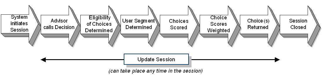

Figure 3-2 shows the basic Oracle RTD processes, which include session start and finish, as well as the Oracle RTD decision process steps.
The steps represent the different stages in the overall process of acquiring the necessary data and processing a decision, as follows:
The system initiates the session.
When a user log on, and the external application connects to Oracle RTD, Oracle RTD establishes a session.
The external application generally acquires as much information about the user as possible, and passes it to Oracle RTD using one or more Informants.
Oracle RTD may also retrieve further information from Data Sources and Entities defined in the Inline Service associated with the external application.
The Advisor calls a Decision.
A request through an Advisor call initiates the decision process. The set of choices to evaluate for the decision is then determined for each of the associated Choice groups.
The eligibility of Choices is determined.
The eligibility rules for the Choices are invoked, to determine which Choices pass on to the next stage of the decision process.
The user segment is determined.
Filtering rules, if created, are then used to segment the user population. Based on the segment, the designated weightings for each of the Performance Goals is used in scoring each eligible Choice.
The Choices are scored.
All eligible Choices are scored for each associated Performance Goal.
The Choice scores are weighted.
Based on the segment, different weights are applied to the Performance Goal scores.
The Choice or Choices are returned to the external application.
Oracle RTD returns one or more Choices to the external application, passing Choice names and any designated Choice attribute that the external application needs. The requesting application then displays the Choices or processes the information accordingly.
The session information is updated.
This step can take place at any stage of the decision process. Its main effect is to update the Oracle RTD server with any new available information about the given session.
In addition, Models can be updated from the session information either at specified integration points or at the end of the session.
The session is closed.
The active Oracle RTD session is closed and any wrap up logic is executed, including learning on any Models defined to learn at session close.

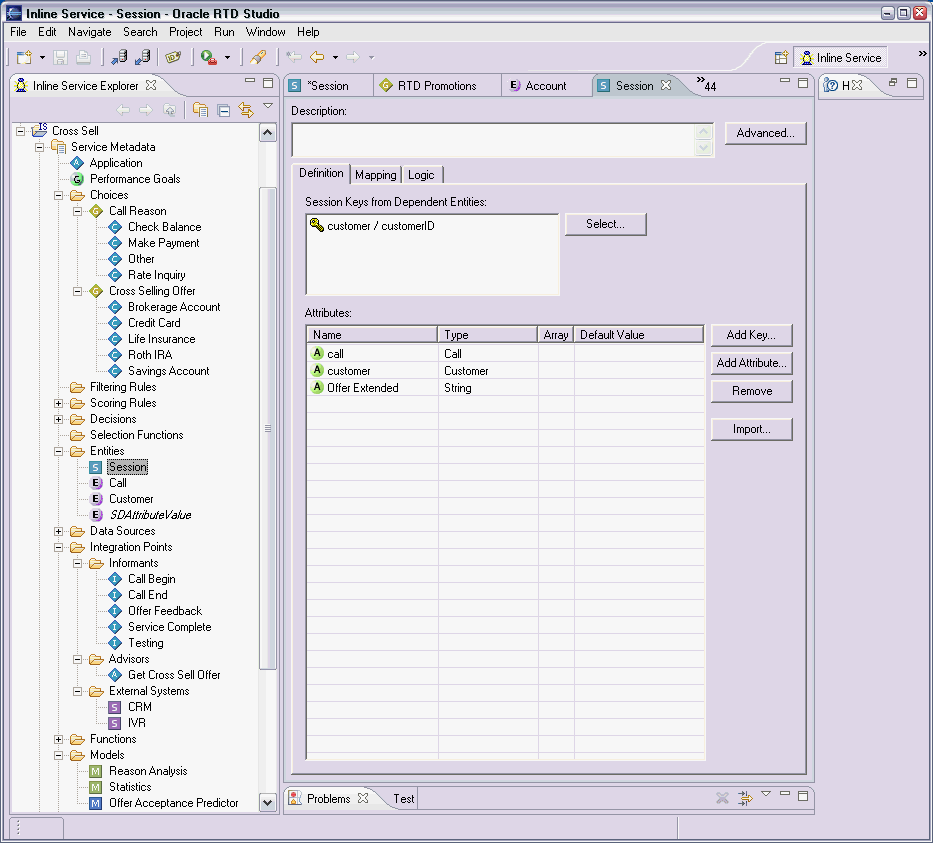

Choice Groups and Choices are the Inline Service elements from which Decisions draw their possible Choices, and which become targets of analysis for Choice and Choice Event Models.
Choice Groups and Choices form a hierarchy, where:
Each Choice belongs to one Choice Group only
Each Choice Group can have one or more sub-Choice Groups
Choices exist only at the lowest level of a Choice Group hierarchy branch.
Choices can be used by a Decision, so that they can be returned by Advisors, and can be registered to either Choice or Choice Event models through Informants.
Choice Group and Choice Attributes
Choice Groups and Choices have attributes, that is, data used in the processing and presentation of Choices.
Typically, you define the attributes of Choices at a higher Choice Group level, where you can also specify default values for the attributes. The Choice Group attributes are inherited by lower level Choice Groups and Choices. You can override default values at the lower levels.
Static and Dynamic Choices
Choices can either be static or dynamic.
Static Choices are explicitly defined in the Inline Service.
Dynamic Choices are Choices that are stored and maintained in an external application, such as promotions stored in a separate marketing application. When required for the decision process, Dynamic Choices are retrieved from the external application. The mechanisms for retrieving and using Dynamic Choices are defined in the Inline Service, but the actual Dynamic Choice values may vary for each user session.
For more information about Dynamic Choices, see the topic Dynamic Choices in the Externalized Objects Management chapter in Oracle Real-Time Decisions Platform Developer's Guide.
Choices and choice groups have rules that determine their eligibility to participate in a decision.
You can define eligibility rules at the Choice Group and Choice levels.
Choices inherit rules from higher levels, and may also have their own rules. At each level, a logical AND is performed between the higher-level rules and the current-level rule, with the result placed in the current-level element.
Choices and Choice Groups can use filtering rules as another form of eligibility. In addition, a filtering rule can also be used to segment the user population for which Decisions are being made, and controls the effect of each Performance Goal associated with the Decision.
Scoring rules are similar in setup to eligibility rules, but rather than evaluate the rule to a TRUE/FALSE outcome, a numeric score is returned instead. A score can be computed for a given Performance Goal tied to a Choice, and can affect the rank of the Choices in the decision process.

Both types of model can be used for prediction and for generating analysis reports.

An Oracle RTD Inline Service consists of all the Oracle RTD elements necessary to interface with an external application and model the desired business process.
The main elements of an Inline Service are the following:
Data Sources
Entities
Integration Points
Decisions
Filtering Rules
Scoring Rules
Models
Performance Goals
Functions
Not all Inline Services have all of these elements. The specific requirements of each external application determine which elements are needed in the associated Inline Service.
For more information on how to configure an Inline Service, see the Related Documents in the Preface chapter, in particular the Oracle Real-Time Decisions Platform Developer's Guide.
In Oracle RTD, you define the Inline Service elements in the Oracle RTD Decision Studio. You must first configure, then deploy an Inline Service to the Oracle RTD server before the Inline Service can be used by an application.
Figure 3-3 shows some of the elements of an Inline Service, called Cross Sell, as displayed in the Decision Studio.
For more information about how to define and deploy Inline Services, see Oracle Real-Time Decisions Platform Developer's Guide.

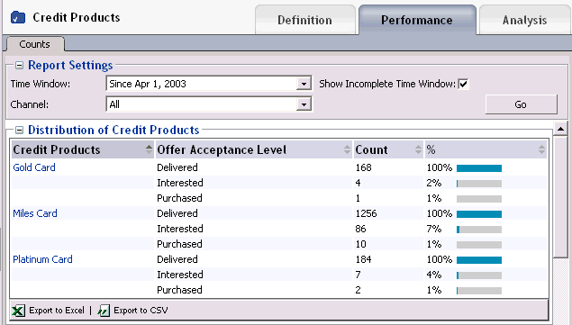

Choice Group Performance Counts
The Choice Group Performance Counts shows the total counts for each choice or choice event occurrence in a choice group.

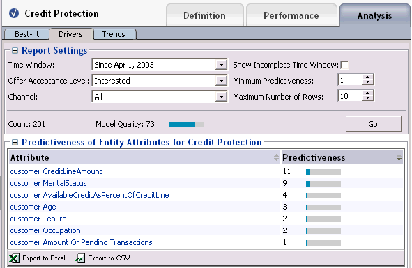

Choice Analysis Drivers
The Choice Analysis Drivers report identifies the attributes that are influential as drivers of predictiveness for each of the choices.
Predictiveness is a measure of the relationship strength between entity attributes, that are the model input, and choice and choice events, that are the model output.
A drilldown on any of the attribute hyperlinks will reveal additional reports about the attribute values themselves.

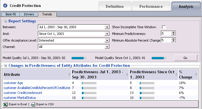

Choice Analysis Trends
The Choice Analysis Trends report shows the change of predictiveness for each of the attributes for a choice over two selected model time windows.
Choice Analysis Best Fit
The Choice Analysis Best Fit report shows all the attributes and values that are most likely to predict the specified event outcome.
