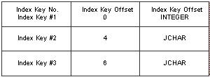

Pass that information to jdeCacheInit or jdeCacheInitEx, and JDECACHE creates this Index Definition Structure for internal use. This table lists Index Definition Structure is for STRUCT letters:
Example of an index definition structure

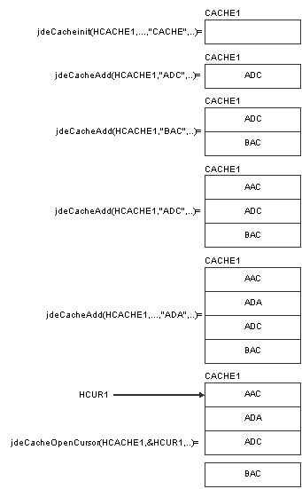

This example illustrates the creation of a JDECACHE cache and a JDECACHE data set:
Example of JDECACHE cache and data set creation
