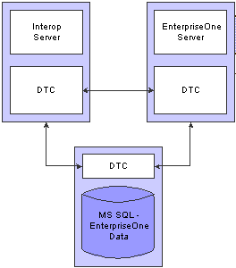

Click to jump to parent topicSetting Up the COM+ Environment
Typically, when you use COM+ for two-phase commit, you must set up the environment for these three computers:
A distributed transaction coordinator (DTC) is expected to run on each of the machines. Before testing the COM+ two-phase commit, you must make sure that the DTCs on each machine are correctly configured and that the DTCs talk to each other.
This illustration shows the physical configuration:
COM+ Environment Configuration
Note. Typically, administrative rights are required for you to run the examples, which talk to DTCs on different machines. For more information about setting up DTC and various configurations, refer to the Microsoft documentation.
