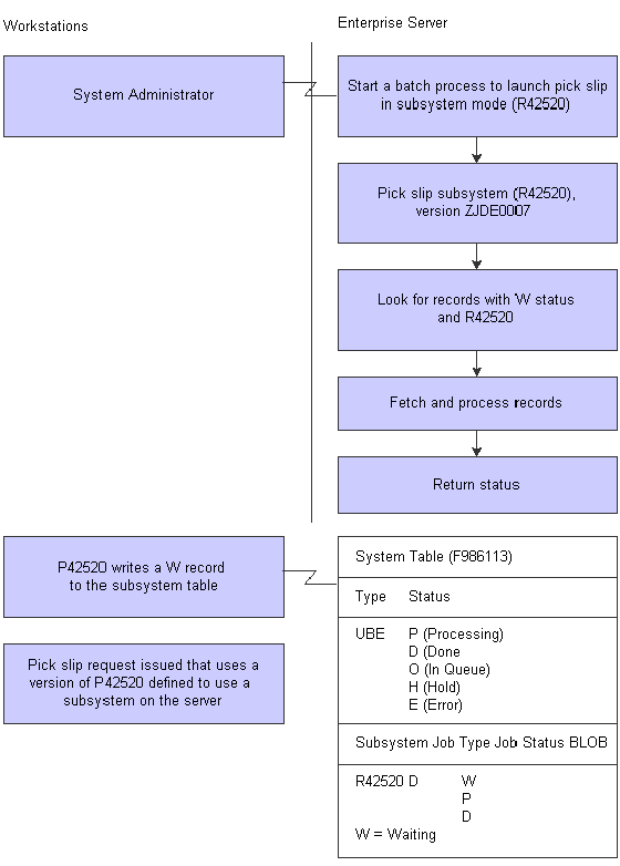

When a JD Edwards EnterpriseOne application issues a request for a job to run as a subsystem job, it places a record in the Subsystem Job Master (F986113) table. This record is identified by a subsystem job name and version, and contains status and operational indicators. Embedded in the record is key information that enables the subsystem to process the record without additional interaction with the requesting application. Key information includes the values for the processing options and the values for the report interconnect data structure. The continuously running subsystem monitors this table for records. If the subsystem finds a record with the appropriate status indicators for the specific report and version being run, it processes the record and updates the status accordingly.
This diagram illustrates how the system processes a subsystem job:
Subsystem processing
