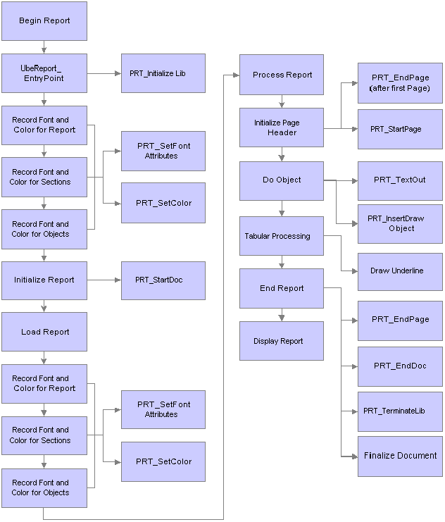

The system processes the components of batch applications in a specific order. At different points during this processing, you can trigger an event through the OSA interface.
This diagram illustrates the OSA execution points:
Execution points for OSA
At each of these execution points, with the exception of PRT_InitializeLib and PRT_TerminateLib, you can call an OSA function. You can create functions or you can use existing XML libraries and their functions.
