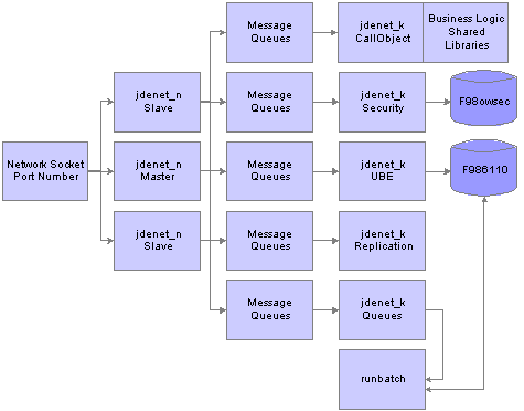

JD Edwards EnterpriseOne Architecture and Process Flow for UNIX and Linux
The host server processes in this flowchart perform the indicated actions.
UNIX host server process
This information explains the process flow:
The jdenet_n Master process spawns jdenet_n Slave and jdenet_k processes (also called kernels) at startup or as they are needed. JD Edwards EnterpriseOne uses a number of different types of kernels to handle different types of processing, even though all of these have the same process name in the operating system (jdenet_k). The definitions for the number of processes to start and what types to start are stored in the JDE.INI file.
The queue kernel process spawns the runbatch process whenever a relevant batch process request is placed in the Job Control Status Master table (F986110). The runbatch process completes the job, updates the F986110 table, and then quits. In JD Edwards EnterpriseOne, you use the Job Queue Maintenance program (P986130) to set up and manage the job queues.
Nearly all jdenet_k processes access various other database tables as needed. The runbatch process, for instance, accesses and modifies any database table that is relevant to the particular business logic it is running.
Message queues are a type of interprocess communication (IPC) resource. They are allocated by the jdenet_n processes by calls to the operating system. While the software is running, operating system information about the message queues can be obtained by using the command ipcs.
When message packets are routed to the jdenet_n process from a client or another server, the jdenet_n process places them in the appropriate message queue according to the type of message. For example, when a client submits a batch process, a message is routed to the batch process kernel; when business logic needs to be run on the server, a request is routed to the CallObject kernel; when a user signs on to the system, a request is routed to the security kernel, and so on.
Each message queue has an identifier (IPC key) so that multiple processes can access them. JD Edwards EnterpriseOne uses a configurable IPC key range, which is controlled by the startIPCKeyValue in the JDE.INI file, in case a conflict occurs with other software that is using IPC resources.

jdenet_n |
The network listener that listens for connection requests. |
jdenet_k |
The jdenet_n process starts the jdenet_k processes, which control JD Edwards EnterpriseOne components, such as the security server, the transaction monitor, and data replication. |
Use the jdejobs command to monitor current batch processes. This example is a sample output:
pfst900 (EnterpriseOne Admin,,,): Semaphores: 1 Shmem Segs: 5 Msg.Queues: 13 Jobs on ent-1: 6137 ttyp6 0:43 jdenet_n 6163 ttyp6 0:44 jdenet_k 6188 ttyp6 0:44 jdenet_k 7213 ttyp6 2:12 jdenet_n 7241 ttyp6 0:47 jdenet_k 9008 ttyp6 1:36 jdenet_n 9009 ttyp6 0:45 jdenet_k 11042 ttyp6 0:09 runbatch
In the output, jdenet_n jobs are listening for requests, and four jdenet_k jobs are handling various JD Edwards EnterpriseOne kernel functions. A runbatch job is processing a report.
