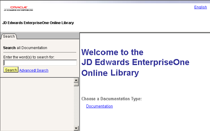

Understanding Implementation Guides and the Online LibraryThe online library is an HTML-based website that contains comprehensive documentation for Oracle's PeopleSoft Enterprise and JD Edwards EnterpriseOne applications and tools. Use this documentation as a research library and as a context-sensitive online help system. It provides standard navigation and search capabilities, including an expandable table of contents, a keyword index, and a full-text search feature.
The online library is organized hierarchically, like a library of books. The home page (index.htm) displays links to all installed documentation types, including implementation guides.
Online library home page

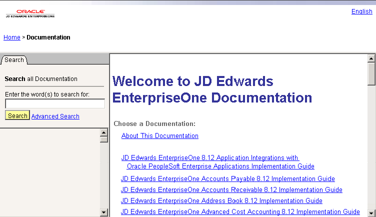

Accessing the Implementation Guides InterfaceWhen you click Documentation on the online library home page, the Implementation Guides Library home page appears in your browser.

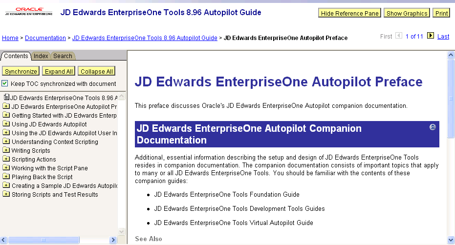

When you select an implementation guide title on the home page, the implementation guide interface appears in your browser:
Implementation guide interface
The implementation guide interface displays three panes:
Document pane.
The pane on the right side of the window displays the document HTML file, which corresponds to a chapter.
Navigation pane.
The pane above the document pane contains display options, navigation controls, and the current implementation guide and chapter titles.
Reference pane.
The pane on the left side of the window contains three tabs: Contents, Index, and Search. Select these tabs to explore the implementation guides or to locate a specific topic. You can hide the reference pane to maximize the size of the document pane.
Note. When you access a topic through the context-sensitive (F1) help, or when you access one implementation guide from another, the reference pane is always initially hidden.
Enabling the Reference PaneIf the reference pane (with the Contents, Index, and Search tabs) doesn't appear, click the Show Reference Pane button in the Navigation pane at the top of the browser. To hide the Reference pane, click the Hide Reference Pane button. If you have cookies enabled on your browser, your last Reference pane setting is remembered when you jump between books. Otherwise, jumping to a new book always hides the Reference pane (to speed page loading).
