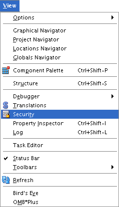

The topics in this section describe how to implement metadata security using the Design Center. You may also implement security through OMB Plus. For more information, refer to the Oracle Warehouse Builder API and Scripting Reference.
Only users with administrative privileges can access the security service under Globals Navigator to manage users and roles of the security policy in Warehouse Builder.

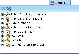

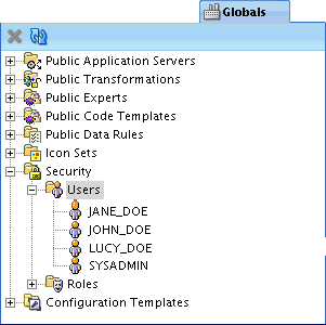

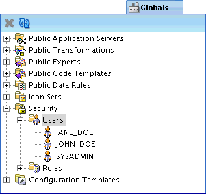

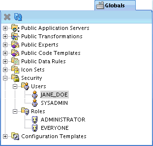

To view default security settings:
In Globals Navigator, expand Security.
Expand Users, and then expand Roles.
Notice that there are two predefined roles, ADMINISTRATOR and EVERYONE.
The one predefined user is the design repository owner; it is assigned the ADMINISTRATOR role by default.
To view or edit the details for a user, in the globals Navigator, under Security and then under Users, select that and double-click the user. The Edit User screen appears.

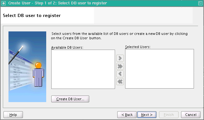

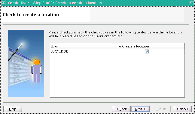

This section explains how to register existing database users.
To register existing database users:

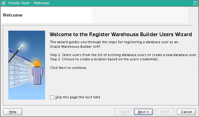

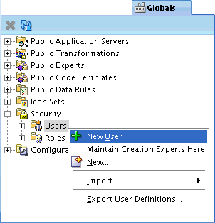

In the Globals Navigator, under Security, right-click Users and select New User.
The Create User: Welcome screen appears.
On the Create User Welcome screen, click Next.

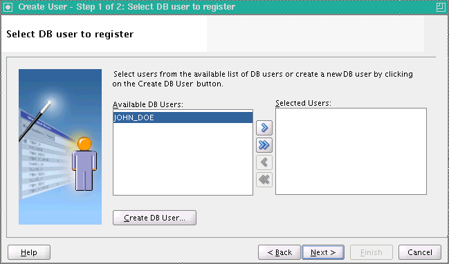

On the Select DB user to register screen, under Available DB Users, select the user or users you want to register, and click the appropriate transfer icon to add the user or users to the Selected Users list.
Click Next.

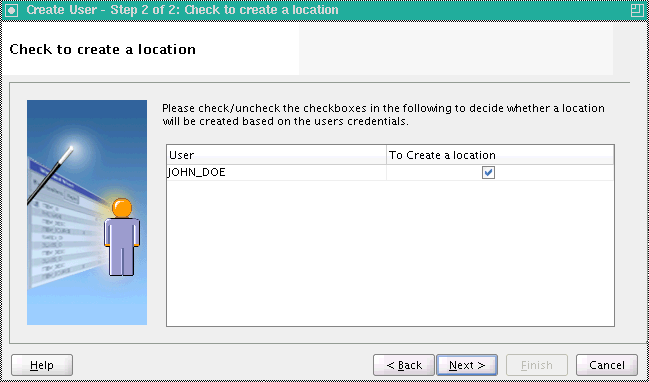

On the Check to create a location screen, check Create option next to the user you are registering.
Click Next.

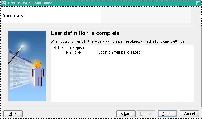

On the Summary screen, review the new user definition.
Click Finish.

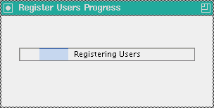

The Register Users Progress appears. It disappears when registration is complete.
Note that your new user is now listed under Users.

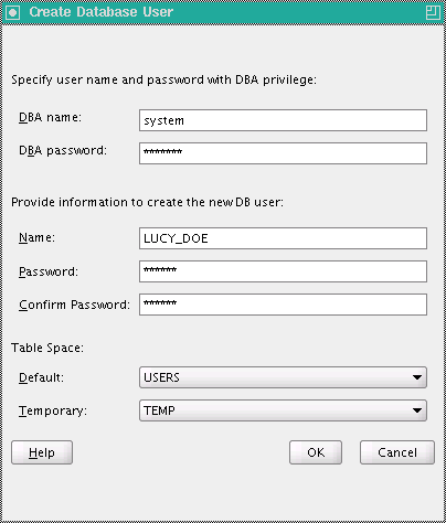

This section explains how to create new database users. You must have the database system privilege CREATE USER.
To create a new database user:
On the Select DB user to register screen, click Create DB User.
On the Create Database User screen, enter the DBA password, and the Name and Password (with confirmation) of the new user.
Click OK.
Note that you must specify a valid user name and password, and adhere to the security standard implemented on the Oracle Database. For more information about user names, passwords, and password complexity verification routines, refer to Oracle Database Security Guide.
Note that on the Select DB user to register screen, the new user is automatically added to the Selected Users list.
Click Next.
Click Next.
Click Finish.

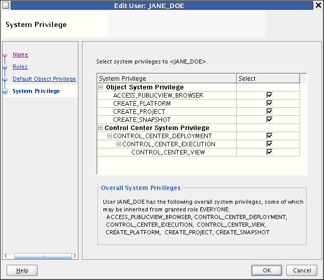

For each user, you can enter an optional description, assign the user to existing Roles, specify the Default Object Privilege and the System Privileges.
These are Oracle Database users, so you cannot rename a user in OWB; you must do that trough Oracle Database.
Note that the granting or revoking of roles and privileges only takes effect in the next session OWB.

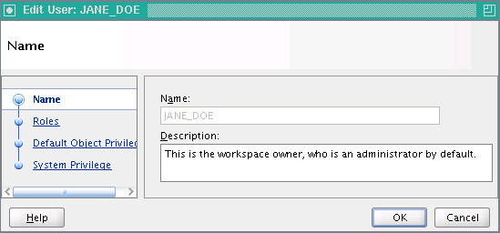

To edit a user profile:
In the Globals navigator, expand Security.
Expand Users.
Select the name of the user for editing. Right-click the user name, and select Open.
The Edit User: Username screen appears. It contains the following options for editing
Name: you cannot change the name itself, but the screen contains an editable Description text field.
Roles: you may assign various roles to the user by moving them from the list of Available Roles to the list of Granted Roles.
Default Object Privilege: you may assign default privileges to either Users or Roles by checking the appropriate boxes under FULL_CONTROL, EDIT, COMPILE, or READ.
System Privilege: you may assign system privileges to the user by checking appropriate boxes under Object System Privilege (ACCESS_PUBLIC_VIEW_BROWSER, CREATE_PLATFORM, CREATE_PROJECT, or CREATE_SNAPSHOT) and Control Center System Privilege (CONTROL_CENTER_DEPLOYMENT, CONTROL CENTER_EXECUTION, or CONTROL_CENTER_VIEW).
When the edits are complete, click OK.

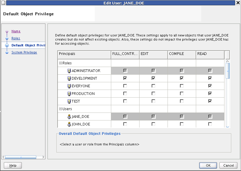

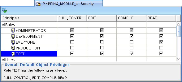

Default object privileges define the access other users and roles have to objects that the selected user creates. These privileges do not impact the privileges the user has for accessing objects created by other users.
For example, for all objects that JANE_DOE creates, JANE_DOE, as well as ADMINISTRATOR and DEVELOPMENT roles, have full access. Note that EVERYONE, PRODUCTION, and TEST roles are restricted to read-only.
If you are familiar with UNIX operating system security, note that the default object privilege is similar to the UMASK command. When you edit the default object privilege, the change only effects objects the user creates subsequently; there is no effect on previously created objects. Therefore, if you set default object privileges early, you can expect little or no additional object-level security management.
To define the privileges other users have to objects the selected user creates, check the appropriate box for each role or user. You can grant the following privileges: FULL CONTROL, EDIT, COMPILE, and READ. All the privileges are additive. If you select COMPILE, then you apply both the compile and read privileges.
Note that access may be granted both to roles and to individual users. Note, however, that when you grant access to a role, the privilege is extended to all users in that role. For example, even though JOHN_DOE is not specifically granted access, he has read access through the EVERYONE role. Furthermore, if JOHN_DOE is a member of the DEVELOPMENT role, he has full control and access.
By default, when you create a new user, the EVERYONE role has full control on all objects. To enable metadata security, edit all user profiles and restrict the access the EVERYONE role has to objects each user creates.

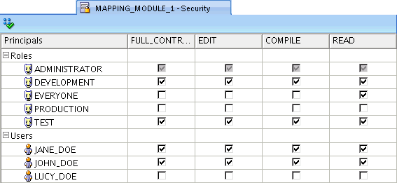

Securing Metadata Objects Throughout their Life Cycle
Default object privileges work in conjunction with object security properties to provide security options throughout the life cycle of a given metadata object. Settings you specify on the Default Object Privilege tab persist until a qualified user overrides the restrictions, on an object-by-object basis.
Assume that JANE_DOE creates several mappings. When JANE_DOE designs and develops these objects, the security policy described earlier in this section may be desirable. However, assume that JANE_DOE completes the mappings and releases the objects to the testing team. In this case, the default object privilege is too restrictive. To extend access to the TEST role, JANE_DOE can select the mapping, then from the View menu, select Security. She can then manually add all necessary privileges to the TEST role.
For more details on overriding the default security on an object by object basis, see "Applying Security Properties on Specific Metadata Objects".
Object privileges apply to all metadata objects in the repository including projects, modules, and collections.
FULL CONTROL
Full control includes all the other privileges plus the ability to grant and revoke privileges on an object. Only users with full control over an object can override default security on an object-by-object basis as described in "Applying Security Properties on Specific Metadata Objects".
EDIT
The edit privilege includes the compile, and read privileges. Additionally, edit allows users to delete, rename, and modify an object.
COMPILE
The compile privilege includes the read privilege and enables you to validate and generate an object.
READ
The read privilege enables you to view an object.

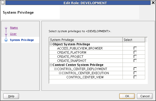

System privileges define user access to workspace-wide services. Use the System Privilege tab to allow or restrict users and roles from performing administrative tasks.
You can control access to the following operations:
ACCESS_PUBLICVIEW_BROWSER: Allows users to access the Repository Browser.
CREATE_PLATFORM: Allows users to create new platforms in the workspace using OMB*Plus.
CREATE_PROJECT: Allows users to create projects, which administrators create projects as a means of organizing metadata objects.
CREATE_SNAPSHOT: Allows users to create snapshots which administrators use when backing up workspaces.
CONTROL_CENTER_DEPLOYMENT: Allows users to deploy to the Control Center and then run those procedures.
CONTROL_CENTER_EXECUTION: Allows users to run procedures from the Control Center.
CONTROL_CENTER_VIEW: Allows users to view procedures from the Control Center.

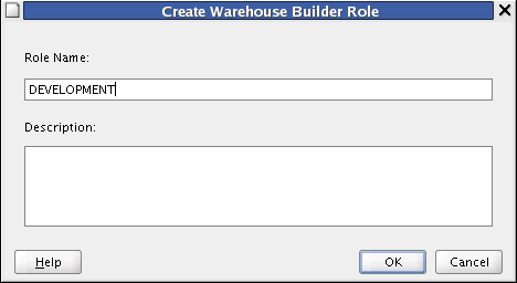

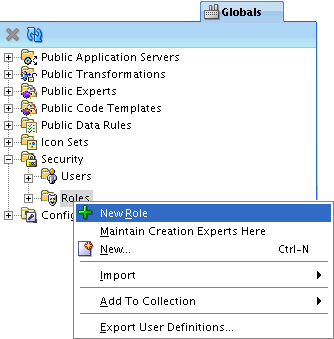

To create a new role:
Under Security, select Roles.
Right-click Roles, and select New Role.
On the Create Warehouse Builder Role screen, enter the Role Name.
Click OK.
Use this role to easily manage privileges for all users. When you register new users, Warehouse Builder assigns those users to the EVERYONE role by default.

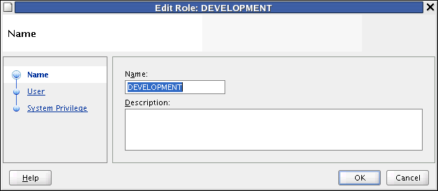

Renaming Roles
From the Globals Navigator, right-click a role and select Rename. You can rename all roles expect the predefined administrator and everyone roles.

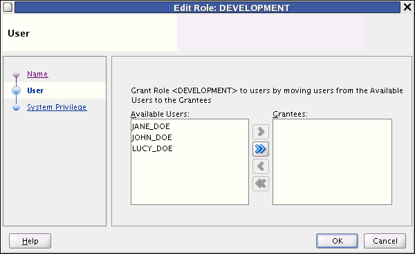

For each role that you create, you can edit the name, enter an optional description, assign the role to existing Users, and specify the system privilege. You cannot rename or edit the descriptions for the predefined roles EVERYONE and ADMINISTRATOR, nor can you delete them. Note that Warehouse Builder roles and database roles are separate constructs; therefore, deleting a Warehouse Builder role has no effect on the database. For more information on system privilege, see System Privileges.

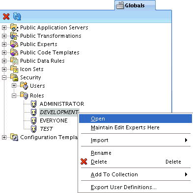

To alter default security privileges for a role:
Under Security, expand Roles.
Select the role to edit, and right-click. From the menu, select Open.
In the Edit Role: RoleName window, you may do any one of the following:
User: you may assign various users to the role by moving them from the list of Available Users to the list of Grantees.
System Privilege: you may assign system privileges to the role by checking appropriate boxes under Object System Privilege (ACCESS_PUBLIC_VIEW_BROWSER, CREATE_PLATFORM, CREATE_PROJECT, or CREATE_SNAPSHOT) and Control Center System Privilege (CONTROL_CENTER_DEPLOYMENT, CONTROL CENTER_EXECUTION, or CONTROL_CENTER_VIEW).
You can assign multiple users to a role. If you want to assign a user that does not display on the Available Users list, then close the editor, create the user from the Security node in the Globals Navigator, and then edit the role. To create a new user, right-click Users from the Security node and select New User. For information on creating and editing users, see Registering Database Users and Editing User Profiles.
You can grant or restrict access to metadata objects on an object-by-object basis.
To change security properties of a specific metadata object:
Select the metadata object for changing.
From the View menu, select Security.
Edit the security privileges for the object, granting and revoking them either at Role level, or at User level.
When all changes are made, from the File menu, select Save All.
Confirm changes.
Use the Security tab to define metadata security on an object-by-object basis. Only users that have full control privileges on an object can change the metadata access controls on the Security tab. Security properties are important in managing the life cycle of your projects, as described in "Example: Using Security Properties to Freeze a Project Design".
While the Default Object Privilege defines metadata security for objects a specific user creates, the Security tab overrides that metadata security policy on an object-by-object basis. Assume that JANE_DOE is a developer that creates mappings and process flows. If you want all objects created by JANE_DOE made available to another developer, such as JOHN_DOE, then use the Default Object Privilege. However, if you want to make only a few objects created by JANE_DOE available to JOHN_DOE or even every user who has a TEST role, locate each object in the Design Center and alter its security options.
To enforce a full metadata strategy, edit the security properties for all projects in the Project navigator. By default, the EVERYONE role has its object privileges set to full control. Change the EVERYONE role privilege to be more restrictive and select Propagate Security Settings icon to apply the changes to all children.
