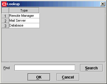

A lookup field enables you to search for a value. The following procedure describes how to use lookup fields.
To use lookup fields:
If the Lookup dialog box contains a short list of fields, click a field, then click OK.
Alternatively, you can select the field and press F4.
Click Cancel to close the Lookup window without selecting anything.
Figure 3-1 shows the Lookup dialog box.
If the Lookup dialog box contains a long list of values, enter the first few characters of the value in the Find box, followed by an asterisk (*), and then click Search.
The Lookup dialog box displays the results that match your search.

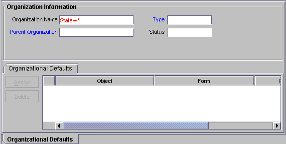

You can filter the search criteria in a form field. Filtering limits the results that are returned to only the records that match the criteria you entered. If you leave all form fields blank before conducting the search, all records in the table are returned.
You can use a wildcard character in a search. The asterisk (*) wildcard character represents unspecified portions of the search criteria. You can use a wildcard character at the beginning, middle, or end of the value that you enter in a field. For example, if you enter B* in the Location field of a Design Console form and execute a search, you retrieve all records with locations that begin with the letter B (for example, Burbank, Boston, Bristol, and so on). If the asterisk is placed in the middle of a search value, as in B*on, you retrieve all records that begin with B and end with ON (for example, Brighton, Boston, and so on). If you place the asterisk at the end of the search value, as in *A, you retrieve all records that end in A (for example, Philadelphia, Tampa, and so on).

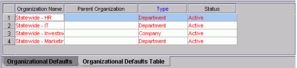

In Figure 3-3, a query is performed on the Organizational Defaults form and the Organization Name field is used to filter the search criteria. The filter Statew* ensures that only organizations with names that begin with Statew are retrieved.
Figure 3-3 Displaying the Results of a Search Query

More than one record is returned. Multiple records in the database match your search criteria. A Table view is displayed, listing all records that meet your search criteria. The first record is displayed in the Form view, as shown in Figure 3-4.

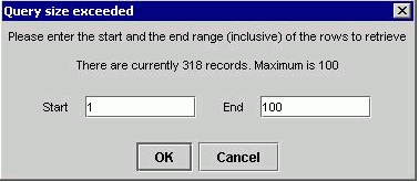

If you have both read and write access to all forms and records in the Design Console in the System Configuration form (that is, if you are a system administrator), you can set the maximum number of records that are displayed in the result set for a search. If the number of records retrieved for a search exceeds this value, the Design Console displays the Query size exceeded dialog box, as shown in Figure 3-5.
Figure 3-5 Query Size Exceeded Dialog Box
You are prompted to enter a specific range or subset of the result set to be viewed. In Figure 3-5, the maximum result set of 100 has been exceeded. Only records 1 through 100 will be displayed.
