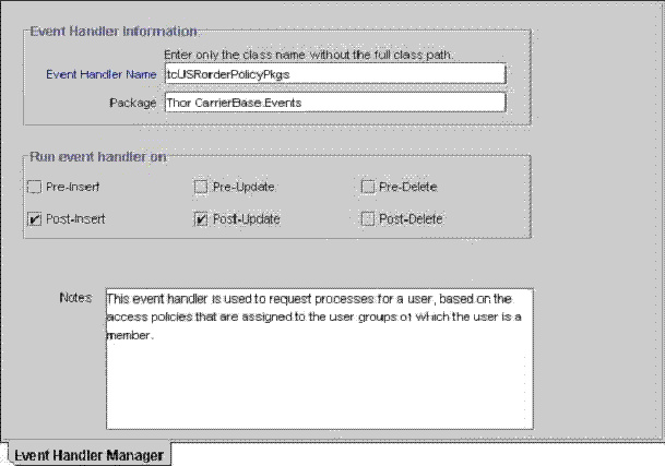

By using the Event Handler Manager form, you can specify when you want Oracle Identity Manager to trigger an event handler. An event handler can be scheduled to run as follows:
Pre-Insert: Before information is added to the database
Pre-Update: Before information is modified in the database
Pre-Delete: Before information is removed from the database
Post-Insert: After information is added to the database
Post-Update: After information is modified in the database
Post-Delete: After information is removed from the database
Figure 9-1 shows the Event Handler Manager form.
Table 9-1 describes the fields of the Event Handler Manager form.
Table 9-1 Fields of the Event Handler Manager Form
| Field Name | Descriptions |
 Event Handler Name  |
 The name of the event handler.  |
 Package  |
 The Java package to which the event handler belongs.  |
 Pre-Insert  |
 If you select this check box, then Oracle Identity Manager will trigger the event handler before information is added to the database.  |
 Pre-Update  |
 If you select this check box, then Oracle Identity Manager will trigger the event handler before information is modified in the database.  |
 Pre-Delete  |
 If you select this check box, then Oracle Identity Manager will trigger the event handler before information is removed from the database.  |
 Post-Insert  |
 If you select this check box, then Oracle Identity Manager will trigger the event handler after information is added to the database.  |
 Post-Update  |
 If you select this check box, then Oracle Identity Manager can trigger the event handler after information is modified in the database.  |
 Post-Delete  |
 If you select this check box, then Oracle Identity Manager will trigger the event handler after information is removed from the database.  |
 Notes  |
 Additional information about the event handler.  |

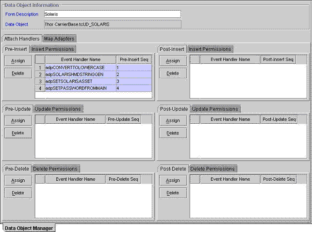

The Data Object Manager form is displayed in the Development Tools/Business Rule Definition folder. You use this form to:
Assign a rule generator adapter, entity adapter, or an event handler to an object that can add, modify, or delete data in the database. This type of object is known as a data object.
Schedule the adapter or event handler to run according to a schedule (pre-insert, pre-update, pre-delete, post-insert, post-update, or post-delete).
Organize the order in which Oracle Identity Manager triggers adapters or event handlers that belong to the same execution schedule.
View the user groups that can add, modify, and delete the current data object.

After you start the Data Object Manager form and select a target data object, the tabs of this form become functional.
The Data Object Manager form contains the following tabs:
Attach HandlersMap Adapters
Each of these tabs is described in the following sections.
You use this tab to select the rule generator adapters, entity adapters, or event handlers that will be assigned to or removed from a data object. This includes the following:
Specifying when Oracle Identity Manager triggers the assigned event handlers or adapters (on pre-insert, pre-update, pre-delete, post-insert, post-update, or post-delete).Setting the order in which Oracle Identity Manager triggers the adapters or event handlers that belong to the same execution schedule.
When an event handler, rule generator adapter, or entity adapter must no longer be triggered by Oracle Identity Manager, you must remove it from the data object.
For example, Oracle Identity Manager can trigger the adpCONVERTTOLOWERCASE, adpSOLARISHMDSTRINGGEN, adpSETSOLARISASSET, and adpSETPASSWORDFROMMAIN adapters on pre-insert. Based on the sequence numbers of these adapters, Oracle Identity Manager triggers the adpCONVERTTOLOWERCASE adapter first, followed by the adpSOLARISHMDSTRINGGEN, adpSETSOLARISASSET, and adpSETPASSWORDFROMMAIN adapters, respectively.
To see the user groups that can add, modify, and delete the current data object, click the Insert Permissions, Update Permissions, or Delete Permissions tabs, respectively.The following sections discuss these procedures:
Assigning an event handler, rule generator adapter, or entity adapter to a data objectOrganizing the execution schedule of event handlers or adaptersRemoving an event handler, rule generator adapter, or entity adapter from a data object
To assign an event handler or adapter:
Select the tab of the Data Object Manager form that represents when you want the adapter or event handler to be triggered.
For example, if you want Oracle Identity Manager to activate an adapter on pre-insert, select the Pre-Insert tab.
From the selected tab, click Assign.
The Assignment dialog box is displayed.
Select the event handler or adapter, and assign it to the data object.
Click OK.
The event handler or adapter is assigned to the data object.
To organize the execution schedule:
Select the event handler or adapter whose execution schedule you want to change.
Click Assign.
Select the event handler or adapter.
If you click Up, the selected event handler or adapter will switch places and sequence numbers with the event handler or adapter that precedes it.
If you click Down, the selected event handler or adapter will switch places and sequence numbers with the event handler or adapter that follows it.
Repeat Steps 3 and 4 until all event handlers and adapters have the appropriate sequence numbers.
Click OK.
The event handlers and adapters will now be triggered in the correct order for the execution schedule or schedules that you organized.
