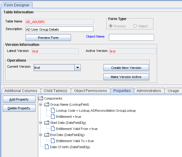

To mark a field as an entitlement in a child process form:
Log in to the Design Console.
Expand Development Tools, and then double-click Form Designer.
Search for and open the child form on which you want to mark an entitlement.
For example, you might want to mark an entitlement on the UD_ADUSRC child form.
Click Create New Version.
Enter a label for the new version, click the Save icon, and then close the dialog box.
From the Current Version list, select the version that you create.

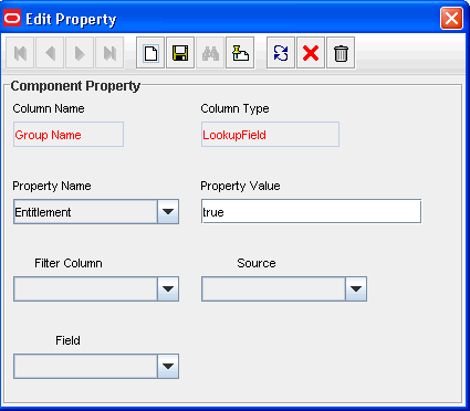

On the Properties tab, select the field that you want to mark as an entitlement and then click Add Property.
From the Property Name list in the Add Property dialog box, select Entitlement.
You can set Entitlement as the property of a field only if the column type is set to LookupField and the property name is set to Lookup Code.In the Property Value field, enter true.
You need not specify values for any of the other fields in the dialog box.
The following screenshot shows the Edit Property dialog box for the lookup field:
Click the Save icon and then close the dialog box.

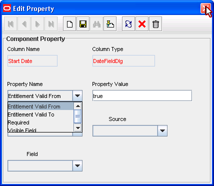

If you want to enable the capture of Start Date and End Date values for the entitlement, then:
You can enable the capture of the Start Date and End Date values only if the column type for both fields is DateFieldDlg.On the Properties tab, select the Start Date field and then click Add Property.
From the Property Name list in the Add Property dialog box, select Entitlement Valid From.
On the Properties tab, select the End Date field and then click Add Property.
From the Property Name list in the Add Property dialog box, select Entitlement Valid To.
The following screenshot shows the Edit Property dialog box for the Start Date field:
Click the Save icon, and then close the dialog box.

The following screenshot shows the Properties tab of the child process form:
Marking Start Date and End Date are optional.Click Make Version Active.
