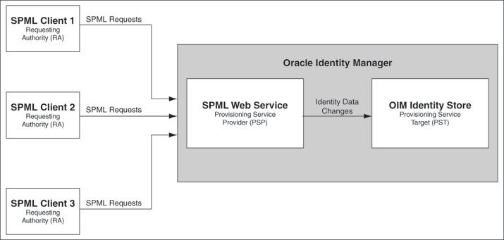

Figure 12-1 illustrates the functional architecture of the SPML Web Service.
The provisioning application can play the role of both an RA and a PSP. Consider the following scenarios:
Provisioning Application as PSP
In this scenario, a client application sends an SPML request to the provisioning application. The provisioning application carried out the request and returns an SPML response to the client application. The request-response exchange is either synchronous or asynchronous. This is typically described as the "inbound" scenario. In Oracle Identity Manager, this is implemented through the SPML Web Service.
Provisioning Application as RA
In this scenario, the provisioning application plays the role of the SPML client and sends an SPML request to a PST, which carries the request and returns an SPML response. The request-response exchange is synchronous or asynchronous. This is typically described as the "outbound" scenario. In Oracle Identity Manager, this is implemented through the generic technology connector containing the SPML Format Provisioning Provider.
Provisioning Application as RA and PSP
