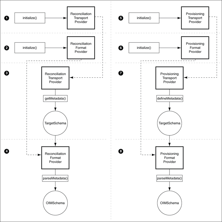

Figure 21-1 shows the metadata detection process.
Figure 21-1 Metadata Detection Process

The following sequence of steps describe how metadata detection is performed. This sequence of steps is based on the assumption that you select both the Reconciliation and Provisioning options while creating the generic technology connector. If you do not select either the Reconciliation or the Provisioning option, then the corresponding steps are not performed.
See Also:
The Javadocs for detailed information about the SPI methods and value objects mentioned in the following steps.
You can access the Javadocs at the following location:
OIM_HOME/documentation/SDK/javadocs/gc/index.html
In the Javadocs, the terms metadata detection and metadata definition have been used interchangeably.
  1. The initialize method of the Reconciliation Transport Provider is called to create an instance of that provider.
  2. The initialize method of the Reconciliation Format Provider is called to create an instance of that provider.
  3. The getMetadata method of the Reconciliation Transport Provider is called to fetch metadata from the target system. The output of this method is the TargetSchema value object containing metadata fetched from the target system.
  4. The parseMetadata method of the Reconciliation Format Provider is called to parse metadata fetched from the target system. The output of this method is the OIMSchema value object containing metadata fetched from the target system.
    The OIMSchema value object corresponds to the Source data sets discussed in the "Providers and Data Sets of the Reconciliation Module" section.
  5. The initialize method of the Provisioning Transport Provider is called to create an instance of that provider.
  6. The initialize method of the Provisioning Format Provider is called to create an instance of that provider.
  7. If the Reconciliation Transport Provider and Reconciliation Format Provider are not able to detect metadata, then Steps 1 through 4 are repeated for the Provisioning Transport Provider and Provisioning Format Provider.

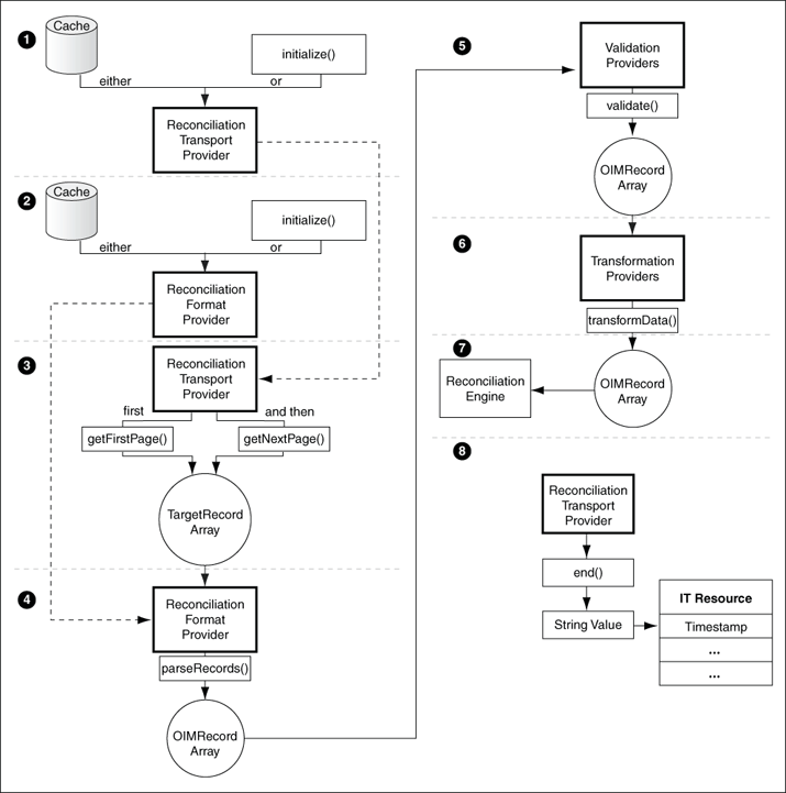

Figure 21-2 shows the role of providers during reconciliation.
Figure 21-2 Role of Providers During Reconciliation

The following steps describe the role of providers during reconciliation:
  1. If an instance of the Reconciliation Transport Provider is not available in cache, then the initialize method is called to create an instance of that provider.
  2. If an instance of the Reconciliation Format Provider is not available in cache, then the initialize method is called to create an instance of that provider.
  3. While using the Administrative and User Console to create a generic technology connector, you can specify a batch size for the reconciliation run. By using this parameter, you break into batches the total number of records that the reconciliation engine fetches from the target system during each reconciliation run. The default value of this parameter is All.
    If you had not specified a batch size, then at this stage of reconciliation, the getFirstPage method of the Reconciliation Transport Provider is called to fetch the entire set of target system records that are ready for reconciliation.
    If you specified a batch size, then the getFirstPage method of the Reconciliation Transport Provider is called to fetch the first batch of target system records for reconciliation. The getNextPage method of the same provider is called (multiple times, if required) if there are more batches of target system records for reconciliation.
  4. The parseRecords method of the Reconciliation Format Provider is called to process each record of the TargetRecord value objects array. The output of this method is an array of OIMRecord value objects.
  5. While creating the generic technology connector, if you selected Validation Providers to validate data while it is in transit from the Source data sets to the Reconciliation Staging data sets, then:
    1. An instance of the Validation Provider is created.
    2. The validate method of each Validation Provider is run on the specified attribute of each record of the OIMRecord value objects array.
    If you did not select Validation Providers while creating the generic technology connector, then Step 5 is not performed and each element of the OIMRecord value objects array is passed on to Step 6.
  6. While creating the generic technology connector, if you selected Transformation Providers to modify data that is in transit from the Source data sets to the Reconciliation Staging data sets, then:
    1. An instance of the Transformation Provider is created.
    2. The transformData method of the Transformation Providers processes the OIMRecord value objects array that was generated as the output of one of the following:
      • The validate method of each Validation Provider (if you selected Validation Providers)
      • The parseRecords method of the Reconciliation Format Provider (if you did not select Validation Providers)
    If you did not select Transformation Providers while creating the generic technology connector, then Step 6 is not performed and each element of the OIMRecord value objects array from the previous step (Step 4 or 5) is passed on to Step 7.
  7. At this stage, the OIMRecord value objects array corresponds to the Reconciliation Staging data sets discussed in the "Providers and Data Sets of the Reconciliation Module" section. Each element of the OIMRecord value objects array is passed on to the reconciliation engine.
  8. At the end of the reconciliation procedure, the end method of the Reconciliation Transport Provider is called. This method returns a string value, which the generic technology connector framework stores in the Timestamp parameter of the IT resource. The framework uses the Timestamp parameter to track the stage at which the reconciliation run was completed.

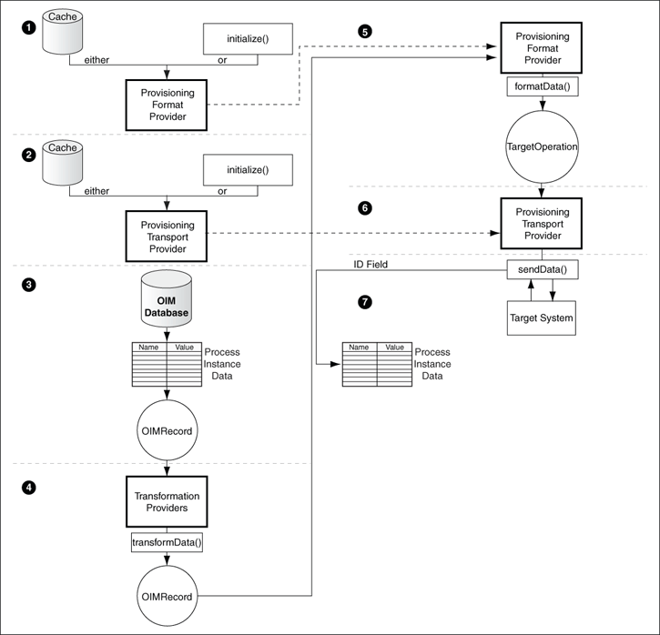

Figure 21-3 shows the role of providers during provisioning.
Figure 21-3 Role of Providers During Provisioning

The following steps describe the role of providers during provisioning:
  1. If an instance of the Provisioning Transport Provider is not available in cache, then the initialize method is called to create an instance of that provider.
  2. If an instance of the Provisioning Format Provider is not available in cache, then the initialize method is called to create an instance of that provider.
  3. The generic technology connector adapter is one of the connector objects created when you create the generic technology connector. This adapter converts the provisioning data record into a hashmap of name-value pairs. This hashmap contains process instance data. Each hashmap is then converted into an element of the OIMRecord value object. At this stage, the OIMRecord value object corresponds to the OIM data sets discussed in the "OIM Data Sets" section.
  4. While creating the generic technology connector, if you selected Transformation Providers to modify data that is in transit from the OIM data sets to the Provisioning Staging data sets, then:
    2. The transformData method of the Transformation Providers processes the specified attributes of the input OIMRecord value object and converts these records into an output OIMRecord value object. At this stage, the OIMRecord value object corresponds to the Provisioning Staging data sets discussed in the "Providers and Data Sets of the Provisioning Module" section.
  5. The formatData method of the Provisioning Format Provider is called to process the OIMRecord value object. The output of this process is the TargetOperation value object.
  6. The sendData method of the Provisioning Transport Provider is called to send the TargetOperation value object to the target system.
  7. If the provisioning operation is a Create request, then the outcome is one of the following events:
    • On successful completion of the Create operation on the target system, the ID field value assigned to the newly created user account is returned by the sendData method. This value is then passed on to the generic technology connector framework, which posts this value to the database.
    • If the ID field value is not returned, then it is assumed that the Create operation has failed. An error message is then displayed on the Administrative and User Console.
    • If the operation fails at any stage after the name-value pairs are created, then an error message is displayed on the Administrative and User Console.
    If the provisioning operation is an Update or Delete request, then the ID field is one of the name-value pairs. When this type of provisioning request is sent, the outcome is one of the following events:
    • On successful completion of the Update or Delete operation, the ID field value may or may not be returned depending on the implementation of the Provisioning Transport Provider.
      In either case, the generic technology connector framework does not need the ID field value.
