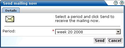

You can use the Mailing facility to obtain a ready overview of the reports you receive through automatic e-mails, and the frequency (daily, weekly, or monthly) with which they are sent to you. An example is shown in Figure 2-5.
Use the check boxes to the right of a report to specify the frequency with which you want to receive a report. Alternatively, right click a report and selecting Mailing and the report frequency (Daily, Weekly, or Monthly). You can also select Remove from mailing to stop receiving the selected report.
You can use the Daily, Weekly, or Monthly command buttons in the Send mailing now panel to request previous reports. If a Send mailing now command button is unavailable, it means that there are no reports in the mailing list with that frequency.
The report mailing facility is scheduled to run at 6 am (Reporter system time) every day.For example, if you click Weekly, a list (shown in Figure 2-7) allows you to select a particular week, and you will receive all the weekly reports for the selected week that are currently checked in your mailing profile.
