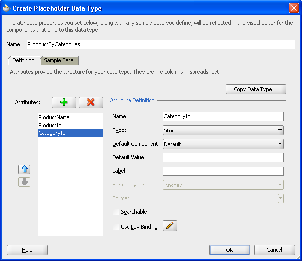

To create a placeholder data type manually:
  1. In the Data Controls panel, right-click the placeholder data control and choose Create Placeholder Data Type.
    Figure 29-3 shows the Create Placeholder Data Type dialog.
    Figure 29-3 Create Placeholder Data Type Dialog
    If you had already added placeholder data types previously and want only to add or edit them, choose Edit Placeholder Data Type from the context menu instead. The dialog that appears will be the Edit Placeholder Data Type dialog. It has the same options as the Create Placeholder Data Type dialog.
  2. If you already have data types defined for another placeholder data control, and you want to copy or append them, click Copy Data Type.
    1. In the Copy Placeholder Data Type dialog, as shown in Figure 29-4, select the placeholder data type you want. Select Replace to replace the current attributes with the attributes from the file, or select Append to add the attributes from the file to the list of current attributes.
    2. Select the Copy Sample Data checkbox to load sample data from the file.
    3. Click OK.
    Figure 29-4 Copy Placeholder Data Type
    Copy Placeholder Data Type dialog.
  3. In the Create Placeholder Data Type dialog, enter a name for the placeholder data type, and then in the Attributes Definition section, enter:
    • Name: Enter a name for the attribute.
    • Type: Select a type for the attribute from the dropdown list. The supported types are String, Boolean, Date, and Number.
    • Default Component: Select a default component for the attribute from the dropdown list. For an LOV, select Combo Box List of Values.
    • Default Value: Enter the initial value for the attribute.
    • Label: Enter a label for the attribute. The label will be used when the component is displayed.
    • Format Type: This field is enabled only when the type is Date or Number. Select a format type from the dropdown list.
    • Format: This field is enabled only when a format mask has been defined for that format type.
    • Searchable: Select this checkbox to make the attribute searchable.
    • Use Lov Binding: Select this checkbox if you want the attribute to be an LOV. To configure the attribute, see Section 29.3.3, "How to Configure a Placeholder Data Type Attribute to Be an LOV".
    Click the Add icon to add more attributes.
  4. To add data, use the Sample Data tab. For that procedure, see Section 29.3.6, "How to Add Sample Data".
    You need sample data for runtime and for a consistent design time.
  5. Click OK.

    Figure 29-8 shows the Create Placeholder Data Type dialog for entering detail data type attributes.
    Figure 29-8 Create Placeholder Data Type Dialog
  3. In the Create Placeholder Data Type dialog, enter a name for the detail data type.
  4. The first attribute in the master data type appears in the Attributes section. This attribute provides the foreign key relationship.
    Add attributes for the detail data type, copy data type attributes from another data type, or create attributes automatically by importing sample data from a CSV file. For the procedure to add attributes, see Section 29.3.1, "How to Create a Placeholder Data Type".
  5. Click OK.
The Data Controls panel should display the detail data type as a child of the master data type, as shown in Figure 29-9.
