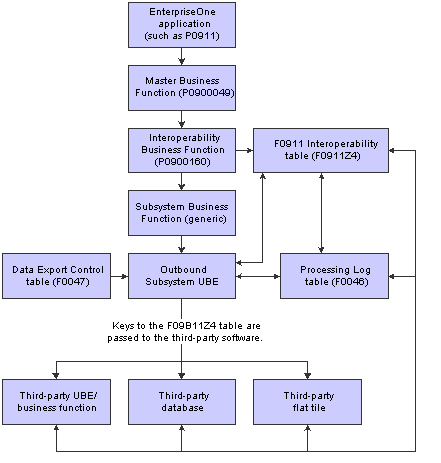

Example: Outbound Interoperability
This example shows one outbound interoperability process:
Example of the General Accounting Outbound Interoperability process
In this example, transactions are created in the General Accounting Journal Entry program (P0911) in JD Edwards EnterpriseOne and sent through the outbound interoperability process to a third-party software package.
