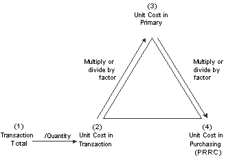

After all unit costs, extended costs, and transaction amounts are converted to the new base currency, the conversion programs recalculate the Unit Cost in Purchasing (PRRC).
This graphic is an illustration of Unit Cost in Purchasing recalculations:
Recalculation of Unit Cost in Procurement
To recalculate PRRC in the new base currency, the conversion programs perform calculations in sequential order:
Add the extended price (AEXP) and amount on hold (ACHG) to derive the transaction total (total order amount).
(AEXP) + (ACHG) = (Transaction Total)
Divide the transaction total by the quantity to derive the transaction unit price.
(Transaction Total) / (Quantity) = (Unit Cost in Transaction)
Depending on the unit of measure (UOM) conversion factor from transaction to primary, multiply or divide the factor to derive the Unit Cost in Primary.
(Unit Cost in Transaction) (× or /) Factor = (Unit Cost in Primary)
Depending on the UOM conversion factor from primary to purchasing, multiply or divide the factor to derive the Unit Cost in Purchasing (PRRC).
(Unit Cost in Primary) (× or /) (Factor) = [Unit Cost in Purchasing (PRRC)]
