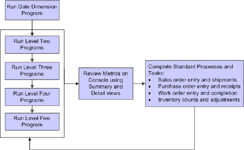

The JD Edwards EnterpriseOne PMD system uses multiple batch programs to load and create the metric data information. You must run the batch programs in a sequential manner for the metric data to be complete and accurate. This diagram illustrates the JD Edwards EnterpriseOne PMD business process flow for data:

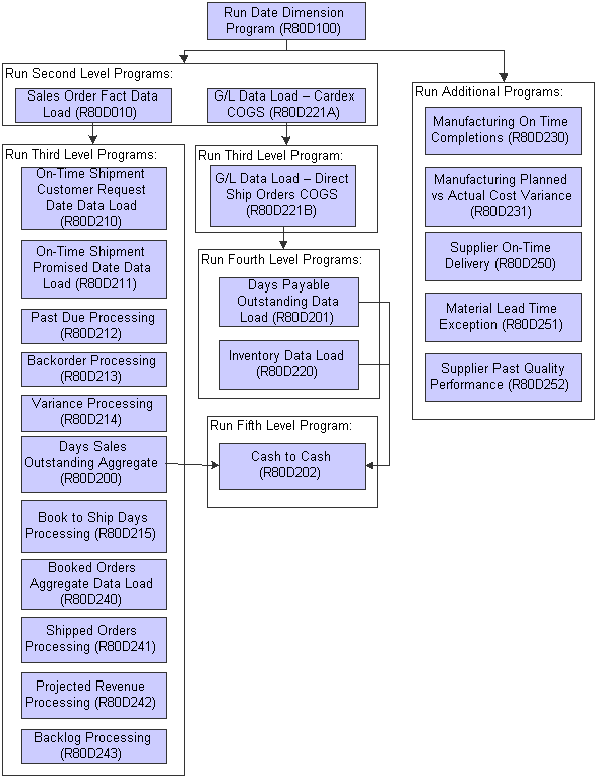

The system must populate tables with data within the JD Edwards EnterpriseOne PMD before you can run subsequent batch programs. The programs have been grouped into different levels based on the data contingencies:
Level |
Program |
One |
Date Dimension (R80D100) |
Two |
Sales Order Fact Data Load (R80D010) G/L Data Load - Cardex COGS (R80D221A) Manufacturing On Time Completions (R80D230) Manufacturing Planned vs Actual Cost Variance (R80D231) Supplier On-Time Delivery (R80D250) Material Lead Time Exception (R80D251) Supplier Pass Quality Performance (R80D252) |
Three |
Days Sales Outstanding Aggregate (R80D200) On-Time Shipment Customer Request Date Data Load (R80D210) On-Time Shipment Promised Date Data Load (R80D211) Past Due Processing (R80D212) Backorder Processing (R80D213) Variance Processing (R80D214) Book to Ship Days Processing (R80D215) G/L Data Load - Direct Ship COGS (R80D221B) Booked Orders Aggregate Date Load (R80D240) Shipped Orders Processing (R80D241) Projected Revenue Processing (R80D242) Backlog Processing (R80D243) |

This flowchart illustrates the sequential order in which all the PMD data load batch programs should be run:
JD Edwards EnterpriseOne PMD data process flow

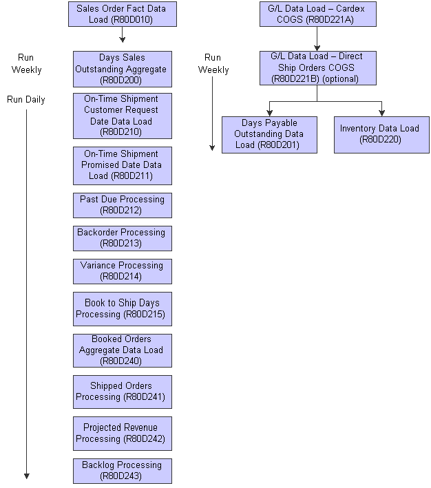

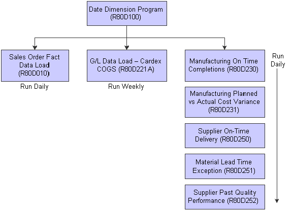

These detail flowcharts show the sequence and frequency that is recommended for each data load batch program to keep the data accurate and timely:
Level one and two batch programs
Level three and four batch programs

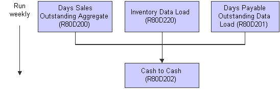

Note. The Inventory Data Load program calculates the metric data for the Inventory Turns and the Days Sales in Inventory metrics.
Level five batch program

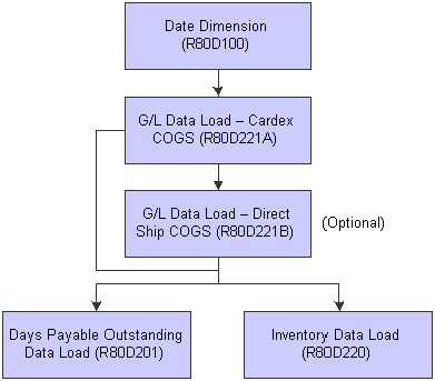

This flowchart shows the sequence for the data load batch programs for the general ledger to keep the data accurate and timely:
General Ledger Data Load program flow
