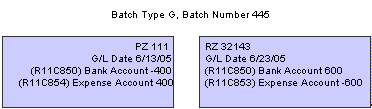

Example: How Cash Basis Entries Are Created
This graphic illustrates how cash basis entries are created for the JD Edwards EnterpriseOne General Accounting, JD Edwards EnterpriseOne Accounts Payable, and the JD Edwards EnterpriseOne Accounts Receivable systems:
Cash basis entries for General Accounting, Accounts Payable, and Accounts Receivable systems
This graphic illustrates the cash basis entries created for JD Edwards EnterpriseOne Accounts Payable and JD Edwards EnterpriseOne Accounts Receivable, based on the previous example:
Cash basis entries for Accounts Payable and Accounts Receivable systems
