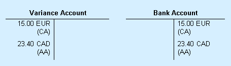

For variance tolerance entries, the calculations are:
CA (F0911) − CA (F0917) = CA difference
2,015.00 − 2,000.00 = 15.00 EUR
AA (F0917) / CA (F0917) = exchange rate
3,120.00 ÷ 2,000.00 = 1.56
CA difference × exchange rate = AA difference
15.00 × 1.56 = 23.40 CAD
T-account for variance tolerance entries
