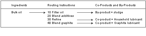

Graphite Lubricant Batch Process
This example illustrates the ingredients, routing instructions in operation number sequence, and the co-products and by-products that the graphite lubricant batch process produces:
