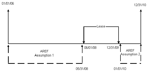

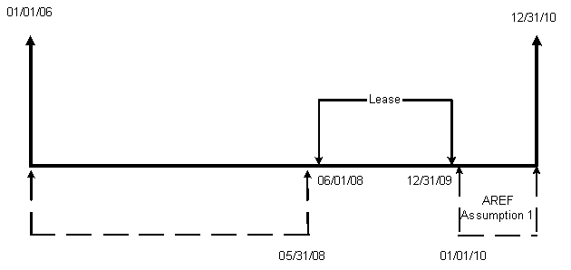

In the AREF Unit Maintenance program (P15L101), you have the option to specify how the time is managed before and after JD Edwards EnterpriseOne Real Estate Management (REM) leases. This diagram illustrates a unit in which an AREF assumption is assigned to the time before the lease:
Assumption Before a Lease
If you want to specify the time prior to a REM lease as downtime, you must select the Time Prior to Lease is Downtime check box. You can also set a processing option in the AREF Load Unit Master program (R15L1012) to enter a default value in the Time Prior to REM Lease field. This diagram illustrates a unit for which the time before the lease is considered downtime:
Downtime Before a Lease

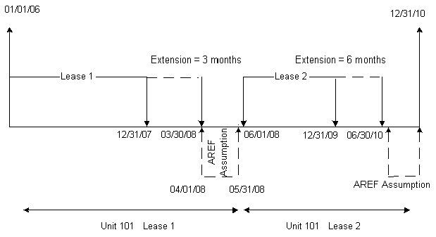

If you want to renew a REM lease using REM terms when a lease expires, as opposed to using the AREF assumptions, you must complete the fields on the REM Lease Renewal tab on the Unit Revisions form. You can also set a processing option in the AREF Load Unit Master program (R15L1012) to enter a default value in the Renew from Existing REM Lease check box.
You can also specify different extensions when a single unit has multiple REM leases. For example, you can assign an extension of three months to the first lease associated with Unit 101, and an extension of six months to the second lease. This diagram illustrates that example:
Renew Lease using REM Terms
