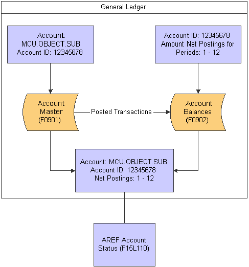

Understanding Account Status Information RetrievalTo calculate a budget for expenses, such as capital expenditures, or any other account for which a bill code is not defined, you must set up accounts with the period balances in the AREF Account Status table (F15L110) with existing information from the Account Master (F0901) and the Account Balances (F0902) tables.
The JD Edwards EnterpriseOne Advanced Real Estate Forecasting system uploads account status information from the JD Edwards EnterpriseOne General Accounting system. In this example, transactions, such as recurring billing amounts, from the JD Edwards EnterpriseOne Real Estate Management system were posted and the Account Balances table (F0902) was updated with the amounts for Account ID 12345678. This diagram illustrates how the system retrieves amounts by Account ID from the F0902 table and updates the F15L110 table:
Uploading accounts status information to the F15L110 table
JD Edwards EnterpriseOne Advanced Real Estate Forecasting provides two methods for uploading information to the F15L110 table:
Use the AREF Account Status program (P15L110) to retrieve and save account information based on parameters that you define.
The advantage of using the online method is that you can modify amounts, delete accounts, and retrieve new accounts before you save them to the F15L110 table.
Run the AREF Global Account Status Retrieval program (R15L1099) to automatically update the F15L110 table based on the data selection and processing option information.
The advantage of using the global method is that you can retrieve accounts more efficiently, depending on the number of accounts and buildings for which you generate budgets and forecast amounts.
You can use processing options to automatically assign a growth pattern to the expense and balance sheet accounts. If you leave the processing options blank, the system assigns the growth pattern that is set up for the building constant. The system does not assign a growth pattern to revenue accounts (accounts associated with bill codes), but you can assign one manually, if desired.
The system uses the GLG automatic accounting instructions (AAIs) to determine the account type (expense, revenue, or balance sheet) for assigning the default growth pattern. To be part of the account range, the object account must be equal to or greater than the object account defined by the beginning GLG AAI and less than the object account defined by the ending GLG AAI. Because GLG13 is the last AAI of this type, the system considers all object accounts equal to or greater than GLG13 as expense accounts.

The system stores accounts status information in the AREF Account Status (F15L110) and AREF Account Status Detail (F15L111) tables.
