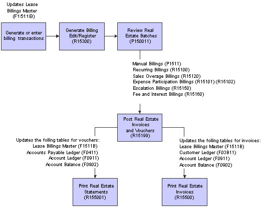

Understanding the FASB 13 Billing ProcessThis table provides lists the steps and descriptions of the FASB 13 billing process:
Step |
Description |
Generate FASB 13 information |
Run the FASB 13 Generation program (R15130) to calculate the effect of FASB 13 on the rent that you bill. The system calculates the straight-line rent for each period, compares it to the actual rent for the period, and determines the accrual or deferral (adjustment) amount. |
Update recurring billings with FASB 13 information |
Run the FASB 13 Recurring Billing Update program (R15132) to generate the FASB 13 recurring billing records that you process into general ledger entries. |
Generate the billing edit register |
After you generate recurring billings, you must run the Billing Edit/Register program (R15300) to ensure that the batch is ready to post. |
Review and approve batches (optional) |
If the Manager Approval of Input option is enabled in the Accounts Receivable or Accounts Payable constants, the system changes the batch status to pending when you successfully generate the billing edit register. You must approve batches that are in a pending status before you can post them. |
Post Real Estate invoices and vouchers |
When batches are at a status of Approved, they are ready to post. Depending on how the lease is set up, you run either the Post RE Invoices to generate invoices or the Post RE Vouchers program (R15199) to generate vouchers. You can use either version of the program to post accrual entries, but you should post the entries in a separate batch. You can segregate billing records that generate accrual entries from other billing records by specifying in the data selection for the post program that the transaction type is equal to A. |
This process flow illustrates the billing process used in the JD Edwards EnterpriseOne Real Estate Management system:
JD Edwards EnterpriseOne Real Estate billing process

Related Tasks for Processing FASB 13 Information
This table describes the tasks to perform after you update recurring billings with FASB 13 information to complete the FASB 13 billing process:
Task |
Description |
Generate the billing edit register (Required) |
After you generate recurring billings for FASB 13, you must run version XJDE0001 of the Billing Edit/Register program (R15300) to validate the transactions in the batch and to change the batch status. See Generating the Billing Edit/Register Report, Generating the Billing Edit/Register Report. |
Review the recurring billing journal |
You can review, revise, and delete the batch of recurring billing records as necessary before you post them. |
Post invoices and vouchers (Required) |
After you generate the billing edit register, you must post the FASB 13 transactions to generate the invoice or voucher records. |
Review FASB 13 billings transactions |
You can review FASB 13 billing transactions in detail using the Billings Transaction Inquiry program (P15211). |
