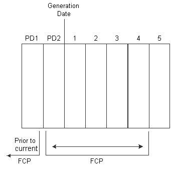

Past Due Time Buckets
The graphic illustrates that you can set the number of past due time buckets to 1 or 2:

You can set the number of past due time buckets to one or two. The first past due bucket (PD2) includes all activity that is scheduled to occur before the current generation date but within the current forecast consumption period. The second past due bucket (PD1) includes all activity that is scheduled to occur before the beginning of the current forecast consumption period.
If you use at least one past due period, the system calculates unconsumed quantity for the first time bucket as follows:
Past due forecasts (-FCST prior to the generation date, but after the forecast consumption beginning date) are consumed by:
Past due sales orders (that have not shipped) that are within the forecast consumption period.
Sales orders that were shipped within the forecast consumption period, but prior to the generation date.
Any remaining -FCST is added to the -FCST in the first bucket that is not past due.
