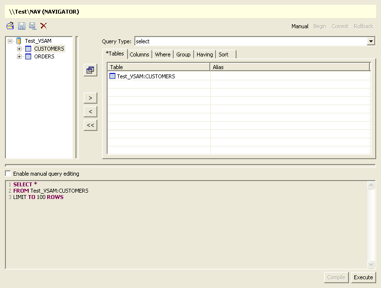

Connection test: This tests the physical connection to the data source.
Query test: This test runs an SQL SELECT query against the data source.
These tests are described in the following procedures.
See Also:
Setting Up a VSAM Data Source for information on how to add a data source.Perform the following to test the physical connection to the data source.
Open Oracle Studio for IMS, VSAM, and Adabas Gateways.
Expand the node of the required computer.
Expand the node of the required binding.
Expand the Data sources node.
Right-click the required data source entity, and select Test.
The Test Wizard screen opens.
Select Navigator from the Active Workspace Name list and click Next.
The system now tests the connection to the data source, and returns the test result status.
Click Finish to exit the Test wizard.
Perform the following to test the VSAM data source by query.
Right-click the required data source entity, and select Query Tool.
The Query Tool opens in the Editor pane, with the Build Query tab displayed (see Figure 4-1).
Select Navigator and click OK.
Select the required query type from the Query Type list. The default is a SELECT-type query.
Locate and expand the node of the required data source entity.
The data source tables are listed.
Select the required table and move it to the Table column by using the arrow button.
Click Execute query.
The Query Result tab opens, displaying the results of the query.

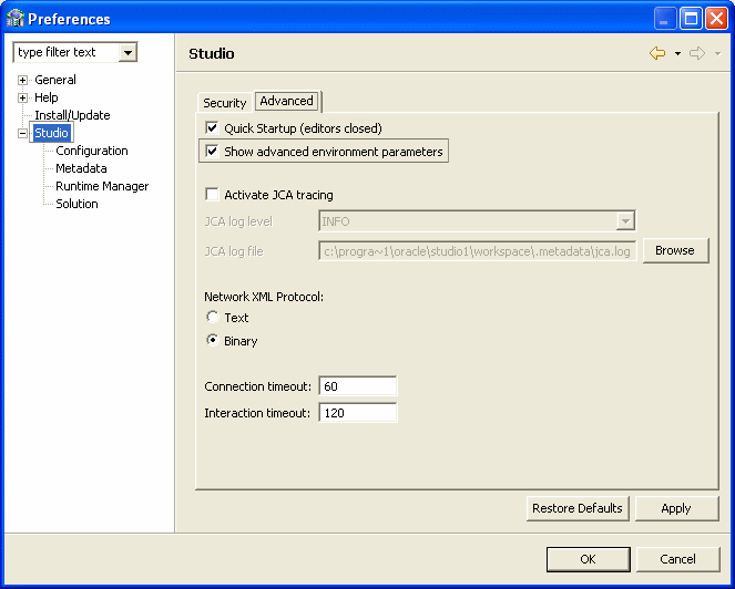

From the main menu, click Windows, Preferences.
The Preferences screen is displayed.
In the left pane, click the Studio node.
Click the Advanced tab.
Select the Show advanced environment parameters check box.
Click OK.

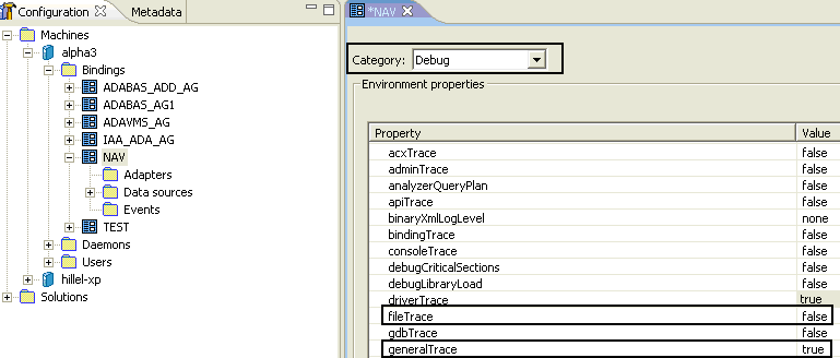

In the Design Perspective Configuration view, right-click the binding under which the Oracle data source is located and select Edit Binding.
From the Category list, select Debug.
Set the driverTrace and generalTrace parameters to TRUE.
Execute the following query: Select * from upd_dt limit to 3 rows
