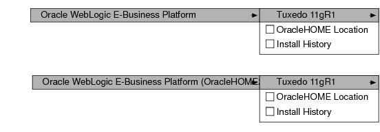

Understanding the Oracle Tuxedo Shortcuts on a Windows System
When installing the Oracle Tuxedo software on a Windows system, the installer program automatically uses Oracle WebLogic E-Business Platform as the parent folder for Oracle Tuxedo. As additional Oracle Home directories are added to the system, the installer program continues to create new Oracle WebLogic E-Business Platform folders using the convention shown in Figure 2‑1.
Figure 2‑1 Tracking Multiple Oracle Home Directories on the Same Windows System
Each Oracle Home directory has an associated Oracle WebLogic E-Business Platform folder. Each Oracle WebLogic E-Business Platform folder contains one or more Oracle product folders (see note) and two files: OracleHOME Location and Install History.
For a given Oracle Home directory and Oracle WebLogic E-Business Platform folder, the ORACLEHOME file contains the pathname of the Oracle Home directory, and the View History file contains a history of installation and uninstallation for the Oracle Home directory. Double-clicking the text icon associated with either file displays its content. The ORACLEHOME and history files contain information extracted from the logs/log.txt file located in the Oracle Home directory.
The Tuxedo 11g Release 1 (11.1.1.1.0) folder (Start →  Programs →  Oracle WebLogic E-Business Platform →  Tuxedo 11g Release 1 (11.1.1.1.0)) contains the following shortcuts:
