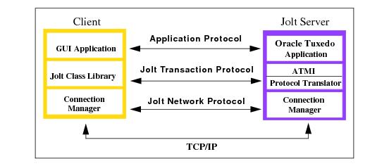

Figure 5‑1 illustrates the client/server relationship between a Jolt program and the Jolt Server.
Table 5‑1 describes the client-side requests and Jolt Server-side actions in a simple example program.

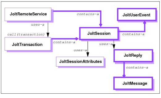

Figure 5‑2 illustrates the relationship between the instantiated objects of the Jolt Class Library classes.
Contains-a relationship—at the class level an object can contain other objects. For example, a JoltTransaction stores (or contains) a JoltSession object.
Is-a relationship—the is-a relationship usually occurs at the class instance or sub-object level and denotes that the object is an instance of a particular object.
Uses-a relationship—an object can use another object without containing it. For example, a JoltSession can use the JoltSessionAttributes object to obtain the host and port information.

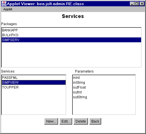

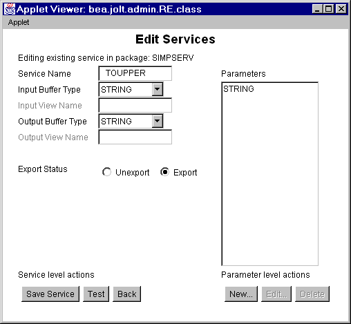

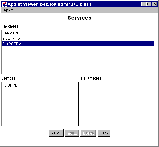

Before running the ToUpper.java example, you need to define the
TOUPPER service through the Jolt Repository Editor.
The ToUpper.java Java code fragment in
Listing 5‑2 illustrates how Jolt works with a service with a buffer type of STRING. The example shows a Jolt client using a STRING buffer to pass data to a server. The Oracle Tuxedo server would take the buffer, convert the string to all uppercase letters, and pass the string back to the client. The following example assumes that a session object was already instantiated.

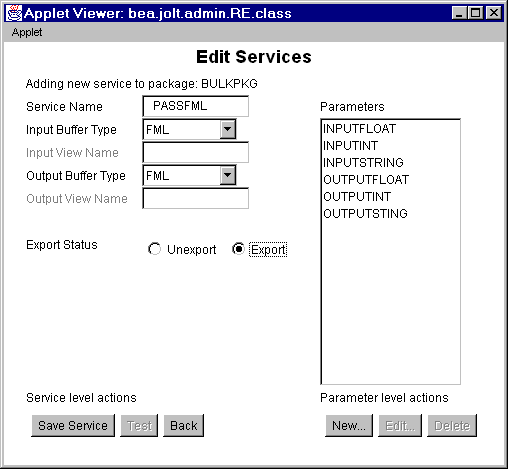

The following tryOnFml examples illustrate the use of the FML buffer type. The examples show a Jolt client using FML buffers to pass data to a server. The server takes the buffer, creates a new FML buffer to store the data, and passes that buffer back to the Jolt client. The examples consist of the following components.
The tryOnFml.java Java code fragment in
Listing 5‑4 illustrates how Jolt works with a service whose buffer type is FML. In this example, it is assumed that a session object was already instantiated.

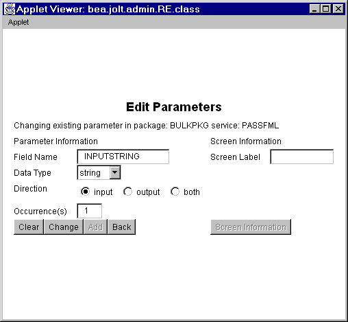

Listing 5‑6 illustrates the server side code for using the FML buffer type. The PASSFML service reads in an input FML buffer and outputs a FML buffer.

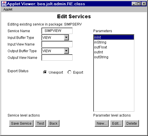

Before running the simpview.java and
simpview.c examples, you need to define the SIMPVIEW service through the Jolt Repository Editor.

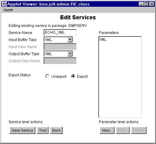

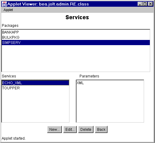

The XML buffer type enables Oracle Tuxedo applications to use XML documents for exchanging data within and between applications. Oracle Tuxedo applications can send and receive XML
buffers, and route those buffers to the appropriate servers. All logic for dealing with XML
documents, including parsing, resides in the application.
