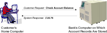

The tpcall(3c) function sends a request to a service subroutine and synchronously waits for a reply. Use the following signature to call the
