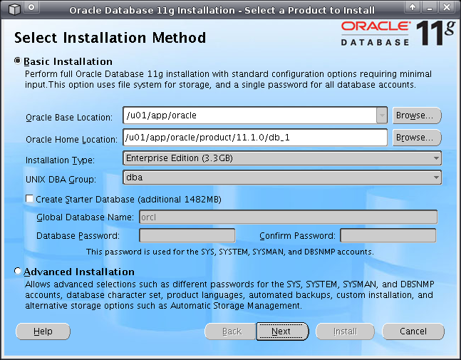

Use the installation wizard, and specify the values shown in Figure 3-1.
Note that the Create Starter Database check box should be unchecked.

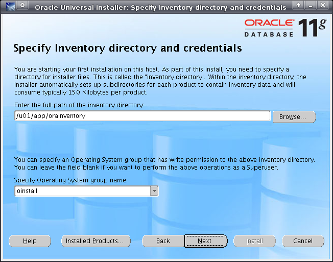

When ready, click Next. Specify the values shown in Figure 3-2. When ready, click Next.
Figure 3-2 Specify Inventory Directory and Credentials
Important:
Any warnings or errors reported during database installation (especially any missing prerequisites) must be resolved before proceeding. See Section 3.3.2, "Installing All Requirements Using a Yum Repository (Alternative)" and Appendix B, "Troubleshooting" for information about required components.If all dependencies are met, you can click Next.

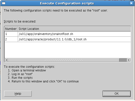

When installation is almost complete, you are prompted to run two scripts, orainstRoot.sh
and root.sh
, as root
. This is shown in Figure 3-3.
Run the two scripts indicated in Figure 3-3. They should be run in a terminal window as root
. You will receive output similar to the following:
/u01/app/oraInventory/orainstRoot.sh Changing permissions of /u01/app/oraInventory to 770.Changing groupname of /u01/app/oraInventory to oinstall.The execution of the script is complete Finished product-specific root actions.
The second script generates the following output:
/u01/app/oracle/product/11.1.0/db_1/root.sh Running Oracle 11g root.sh script... The following environment variables are set as: ORACLE_OWNER= oracle ORACLE_HOME= /u01/app/oracle/product/11.1.0/db_1 Enter the full pathname of the local bin directory: [/usr/local/bin]: Copying dbhome to /usr/local/bin ... Copying oraenv to /usr/local/bin ... Copying coraenv to /usr/local/bin ... Creating /etc/oratab file... Entries will be added to the /etc/oratab file as needed by Database Configuration Assistant when a database is created Finished running generic part of root.sh script. Now product-specific root actions will be performed.
On completion of each script, return the dialog shown in Figure 3-3, and click OK. In the main installer screen, verify that the message "The installation of Oracle database 11g was successful" appears. Click Exit, and confirm by clicking Yes.
