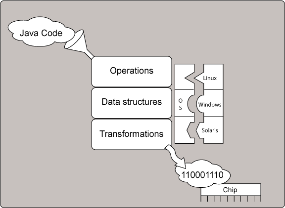

Figure 2-2 shows what happens to Java code as it passes through the JRockit JVM. After Java code enters the JRockit JVM, it passes through the operations stage, the data structure stage, and the transformation stage, before emerging as binary code on a microchip.
Figure 2-2 Inside the JRockit JVM Black Box
Description of Figure 2-2 follows
Description of "Figure 2-2 Inside the JRockit JVM Black Box"
